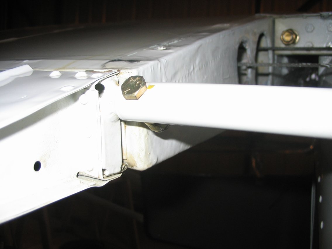

Check to see if somebody over-tightened the connections between the carry thru tube and the flap connection fitting. It is supposed to be a smooth slip fit to accomodate for the dihedral. The fittings connected to the flaps have an elongated slot for that bolt. Might be some binding there?
Those slots get worn, too, and the movement of the torque tube is not transferred to the flaps. The air load takes up the slop by pushing the flaps up.
If this is the case, sometimes you can compensate by adjusting the cable. Set the adjustment to the correct angle with someone pushing up on the flaps.
