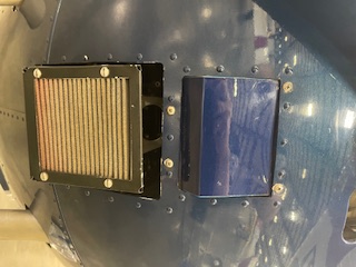

And...the least expensive route is to get a good sheet metal individual who can patch the area that was cut away for the vacuum pump.

I'm pretty sure the nose bowl is a weldable alloy. If so, a good welder could patch it up and you'd never know...

If the poster isnt talking about me then someone else with a 49 is in the same boat. Univair doesn’t seem willing to stand by their statement that the bowl will work on a 49 140A. I have not found where the part numbers match up like one person claimed to have seen so i would really like to hear more or a reference to which parts manual. As of now I will eventually have one of the top warbird restorers patch the cutout unless I cans feel sure that the new nose bowl will absolutely work. Thanks for all the input.

it isn't original look, but is there enough room to mount a light ( landing, taxi or strobe)
