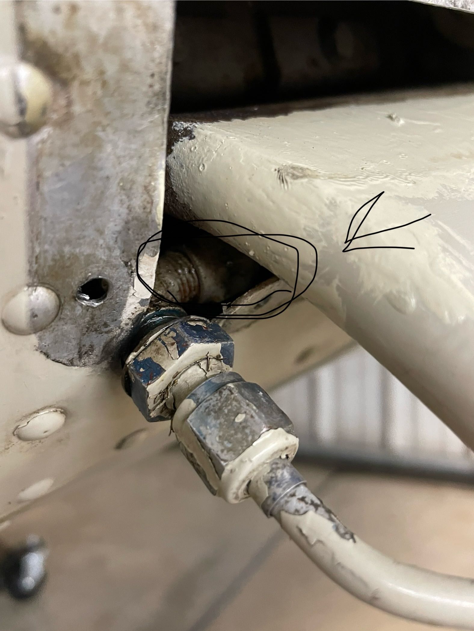

Hello Everyone,
I went out to fly yesterday and was dismayed to find a puddle of red fluid under our '46 140. I have tracked the leak down to the inner end of the 90 degree fitting where the break line exits the aircraft on the right hand side. It should be a matter of simply tightening the fitting however, it appears the landing gear leg may have to come out in order to gain access? Is there some trick to this that I am not seeing that would avoid having to remove the leg? If the leg does have to come off, what is the best way to jack up the aircraft during this time?
Thanks in advance for your guidance.
Patrick

Patrick, I have had to gain access to this area twice on my airplane. Both times the leak was not at the fitting but at a puncture in the line from the fairing fastening screw bottom aft within the circle you drew on your photo. This required replacing that approx 6 inch length of brake line both times. I did it the first time without pulling the gear leg. The second time I pulled the gear leg which made the entire job much easier. The reason I had to go in a second time is because the first go around I thought I could solve the problem by simply shortening the screw. Not so. The second time around I fabricated a new fairing minus a hole in that location and simply eliminated the screw. Problem solved. Ok all you inspectors out there, your're welcome to jump on my case for eliminating that fairing screw. It won't do any good. As long as I own this airplane there will never again be a screw installed in that location. ;)

Hi John, thank you for the insight! I did notice that one of the screw tips had scratched the nut on the fitting so potentially it moved it and loosened it or maybe I have a puncture like you had that I cannot see. When you took the landing gear leg off how did you jack up the aircraft?

Great thread. I just checked that cover plate and sure enough one of the fastening screws was quite close to the brake line. Ground it a little shorter so now I won't worry as much, thanks for the tip-
