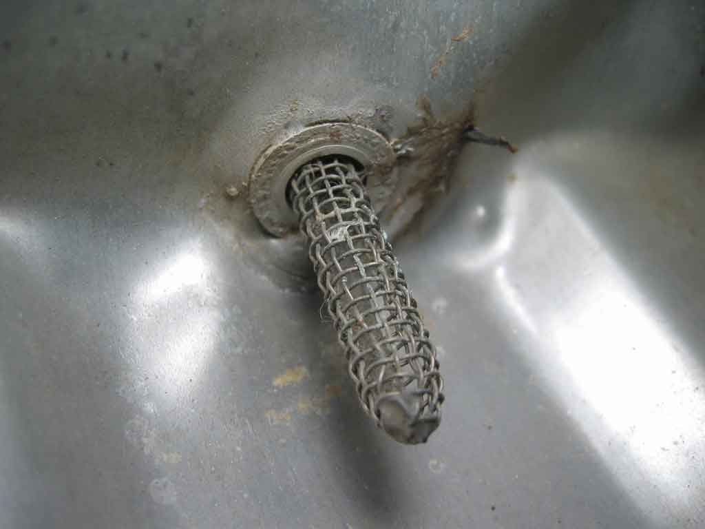

FInger strainers in tanks

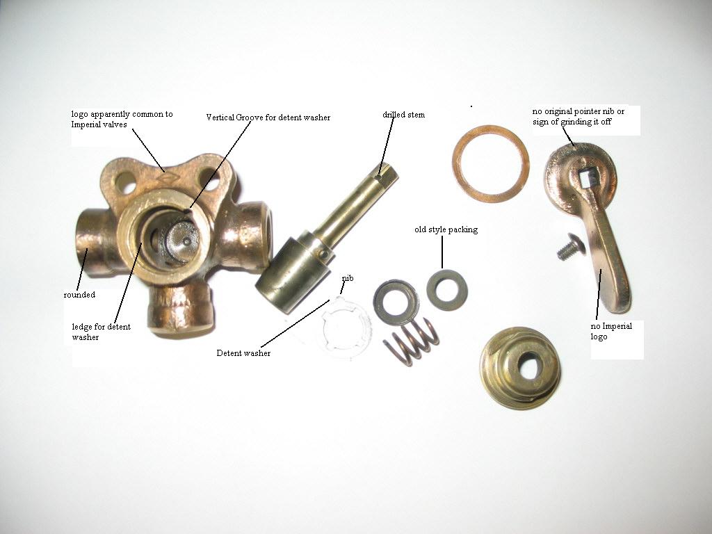

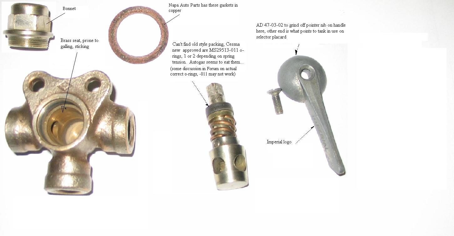

Fuel selector pics, they aren't difficult to work on but John C makes a point about the handle being loose a possibility.
Check to see if you have the old black plug (Jensen) retrofit in your fuel selector. Randy Thompson has a story about his failing. The original Weatherheads had a brass truncated cone that ran against a brass body. When properly lubricated (fuel lube) they worked but would gall eventually. Jensen came up with a polymer plug that self-lubricated which sounded great but apparently they either got brittle or failed somehow. Easy to check, they were black.

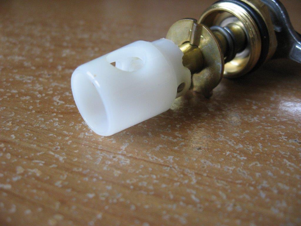

The Weatherhead/Anderson 6749 has a white delrin plug

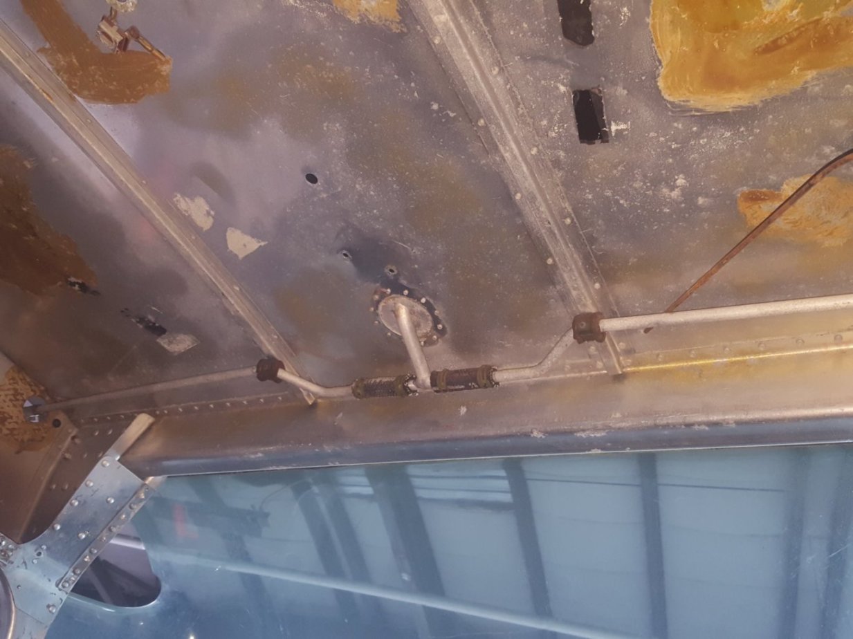

I'm not sure how it would be an issue, but, do you by chance have the tube in the front of the tanks that connects the two air spaces? You should be able to see it (or not) if you remove the forward wing root fairing.
Re: Partial power loss
Posted: Sat Mar 09, 2024 6:03 pm
What John is referring to, this is the tank inter-connect on a 170A but it's the same idea, and much like the inter-connect on a 140A model. The later 120-140's that had the inter-connect I don't believe had the central breather on the top of the cabin.
I've seen several iterations of fuel system bastardizations that the mechanics clearly didn't understand how things worked.
I highly recommend if you haven't already to read Neal's articles on the fuel systems. Correct fuel caps are a must, a lot of shade tree stuff out there.
