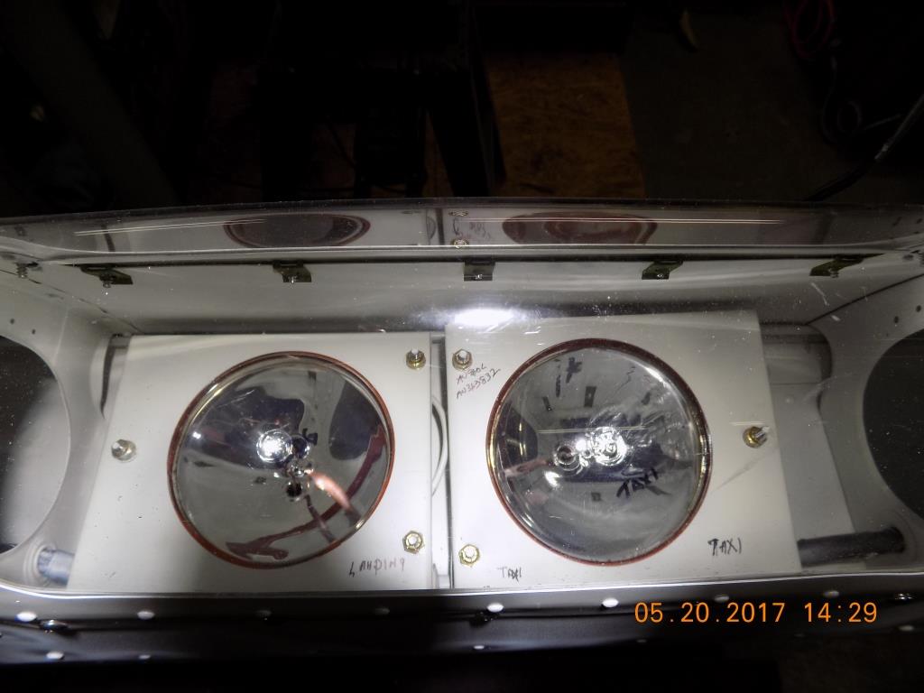

I reversed the long screws AN526-832R screws so the screw heads are behind the spars and used jam nuts with lock washers to secure the bulb retaining plates. This allows changing the bulbs by just removing the front bulb retainer plate, thereby leaving the rear retainer plate intact to preserve bulb alignment. The STC was set up with the screw nuts behind the spar, which means everything has to be disassembled to change the bulbs, and the alignment process repeated.
I also wrapped the edges of my bulbs in 0.020 red silicone tape to provide some shock relief. Tape is available from AC Spruce.
The outboard light is the taxi (tungsten filament is horizontal on GE 4509 bulb); inboard is the landing (tungsten filament is vertical on the GE 4509 bulb). GE 4509 bulb beam spread horizontal is 10 to 12 degree; 6 to 10 deg vertical.

- LE Landing Light Well without Lights Installed.JPG (139.68 KiB) Viewed 5144 times
- LE Lights Side View with Screw Mount Sketch.JPG (125.46 KiB) Viewed 5144 times
- LE Lights Head on View.JPG (128.3 KiB) Viewed 5144 times

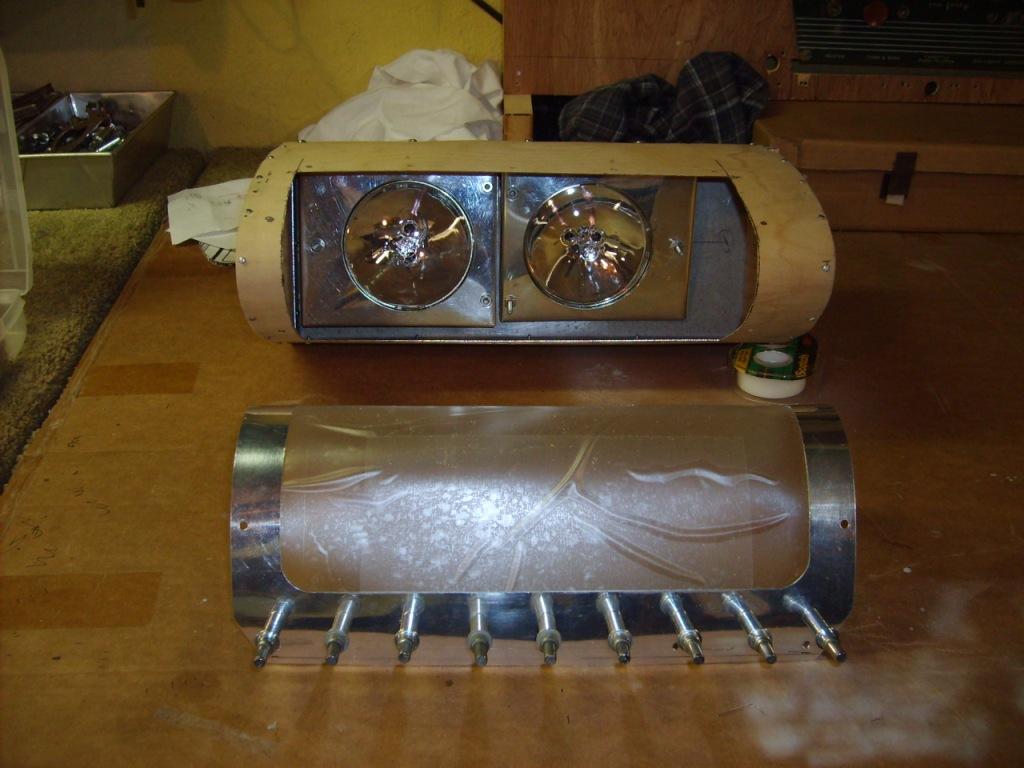

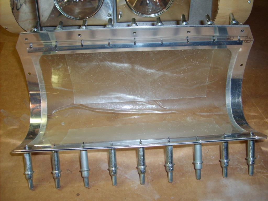

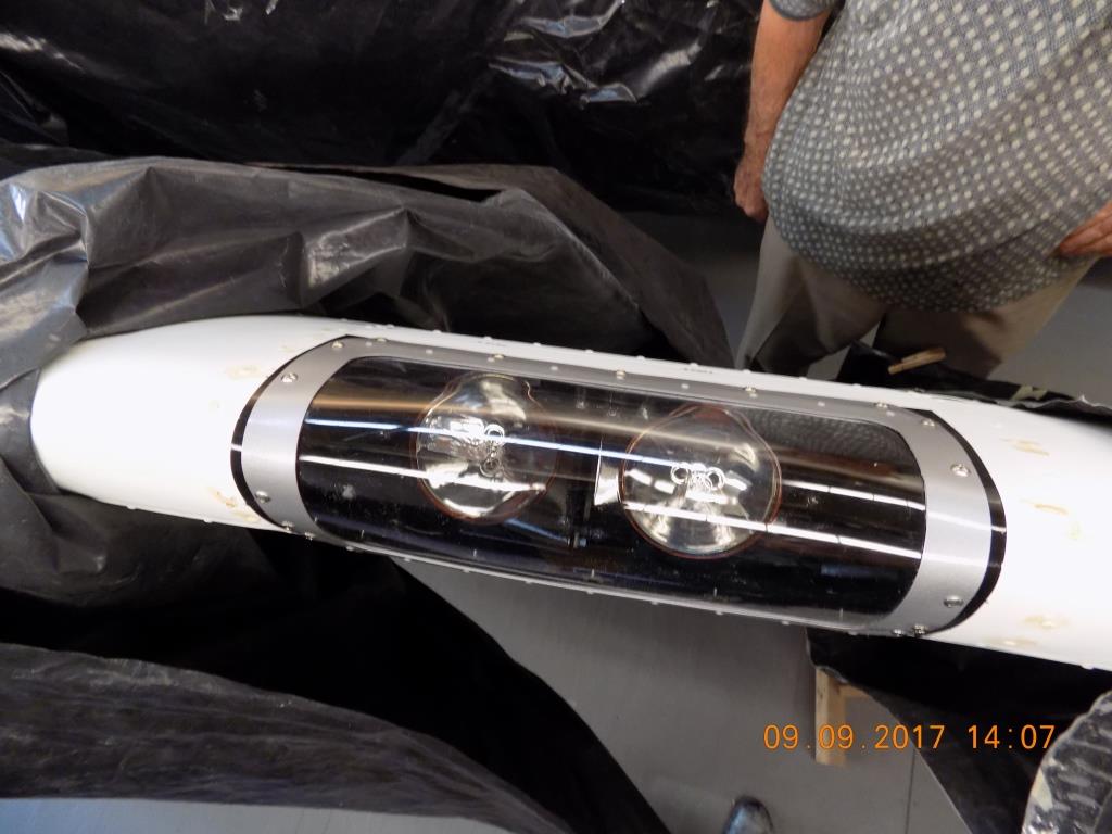

More photos. I made a wooden mockup to form the acrylic lense and to test fit the parts.
- Left Wing Ldg Lite Mckup Overall.JPG (123.83 KiB) Viewed 5144 times
- Left Wing Ldg Lite Lens.JPG (137.62 KiB) Viewed 5144 times
- LE Landing Light Installed after Painting Interior Black.JPG (143.46 KiB) Viewed 5144 times
