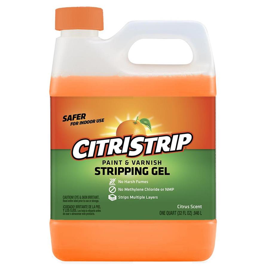

Purely a suggestion, and I don't know if this will work, but what about trying a biodegradable water soluble paint stripper such as Citristrip?

I used the Citrus strip from Lowe’s with a plastic scraper and it worked well on both the glue and that horrible black stuff. Followed up with scotch brute and a little lacquer thinner.

Thank you all so much! Really appreciate the help, once I left the Citri strip on covered overnight a good chunk of it came off. Probably going to have to repeat the process a couple more times but it's nice to see progress.

Put the stripper on then cover it with saran wrap to keep it from drying out.
