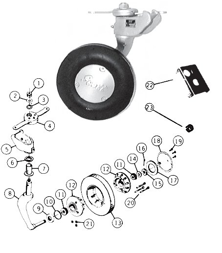

For entertainment...the additional attached pdf file is from an old catalog
Re: Tailwheel Chain Catching
Posted: Sat May 18, 2024 9:25 pm
Item 7 is what controls the side to side slop.
