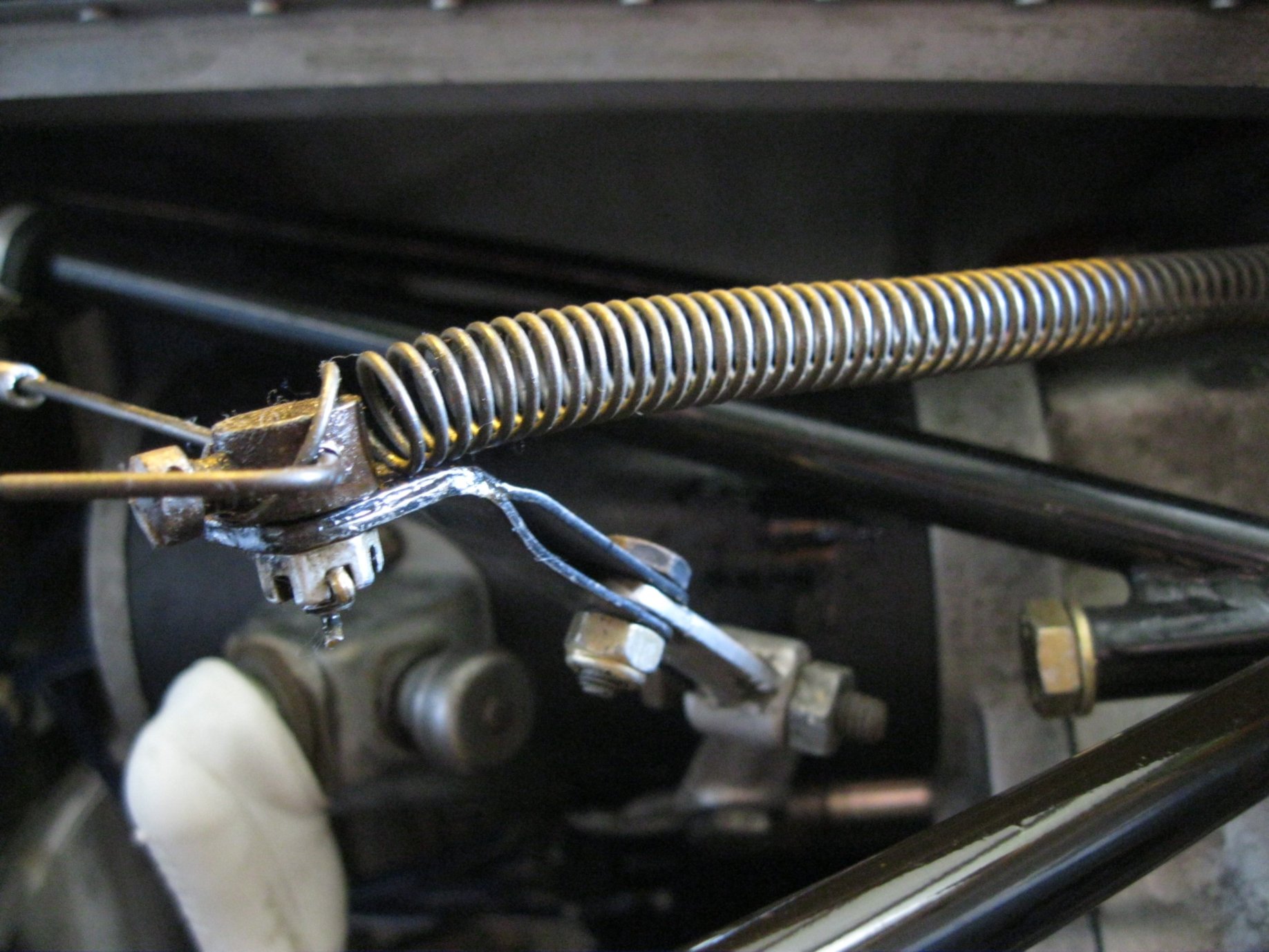

New (to me) 1947 C-120 with a C-90 engine. We're loving the airplane, but have noticed that the starter (T-handle) has become increasingly difficult to engage. Picture attached showing the switch actuator mechanism under the cowling (not familiar with the exact make/model starter).
Question: as a non-A&P, are there any adjustments that we can legally make? (shortening the actuator wire, or maybe extending the screw length that makes contact with the push-rod switch on the starter housing)? Or is this something we should take it to an AMT for?
It definitely feels like it's taking more and more and more effort/travel to engage the starter, to the point where I'm afraid we're going to yank the T-handle out of the panel, with the force required to engage the starter.

I cant see the starter arm, when we had that starter are's had a extended arm added think it was a continental part? But bottom line the new starter with no arms or engaged weird gear is the way to go.

mine does not have that spring. that would make it harder to pull. don't mess with the geometry of the switch. it doesn't effect how hard the pull handle is to operate anyway and it will mess up the timing of the motor turning on when engaging the gear

Best to take it to a mechanic. Each part of the system must be adjusted correctly. Here is a link that shows the process for adjustment.

Does your arm have the extension? This would give you a little more leverage. Also, when i had a pull starter I had to make sure the routing of the cable thru the firewall didn't have any kinks or weird bends that would bind up the wire inside the shroud. I got a new cable/shroud that appeared teflon lined from McFarlanes that made it much easier to use. You can also try lubricating your cable shroud with TriFlow or some such oil.
viewtopic.php?f=10&t=113
Here's a pic of the starter arm extension, I have my old one somewhere....

I don't recognize the extension or the spring as something I'm familiar with. My not recognizing them of course does not make them non-standard. Also, In the photo the spring appears to be chafing on the engine mount. I'm hoping that's just a photographic illusion, and knowing who submitted the photo I'm assuming it is just that - an illusion.

John, you are correct, it (was) not rubbing on the engine mount and it was somewhat an improvement on the 'return' tension of the pull starter cable that came with the plane when I got it. I have seen pull starters with and without a spring. Since then I'm switched to a Skytec starter so no more mussing with the pull starter. Nevertheless, I got good at troubleshooting pull starters here locally. The biggest problem I saw was cable shrouds routed every which way and the old unlined shrouds just had a lot of friction in them for the cable.
