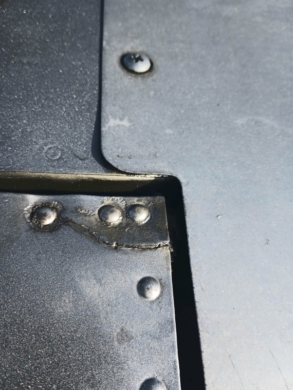

Have a 3/4 “ crack in flap on cessna 140. Top of flap upper right corner and stops at a rivet. What is proper fix for this? Thanks.

On the left flap, upper right hand corner. From inside edge to a rivet. About 3/4” long.

Need your photo - how long has it been there? Possibly sounds like stop drill and watch.

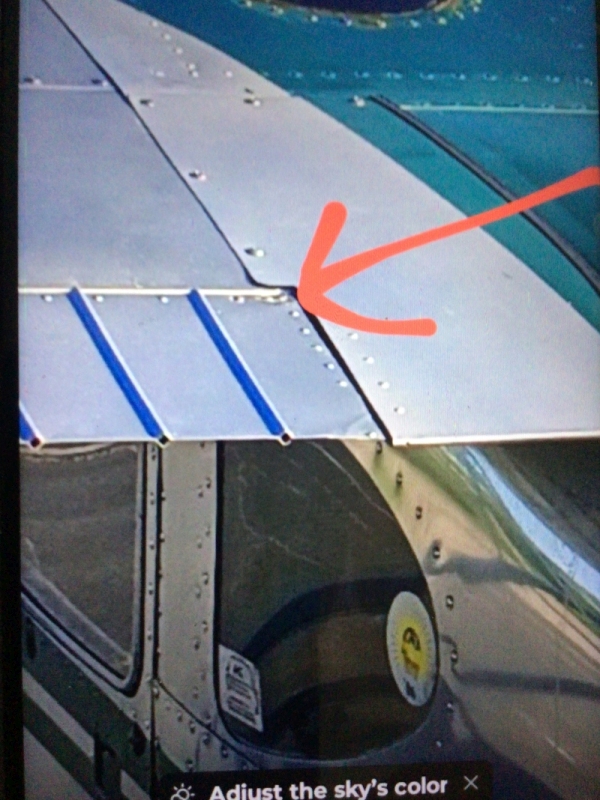

Here are his photos:
That's where the fitting for the torque tube attaches. Are you sure there isn't more damage underneath? I forget exactly how it all fits together, but there must be a spar in there, and a rib, too.

Looks like possibly someone has been there before even added another rivet. Check the same location on the other flap- probably "mirror image" configuration fabrication - post that photo if convenient.
As John C says and I vaguely remember, just extended the flap and look/picture.
Even looks like someone put a narrow coat of the famous JB Weld! :lol:
