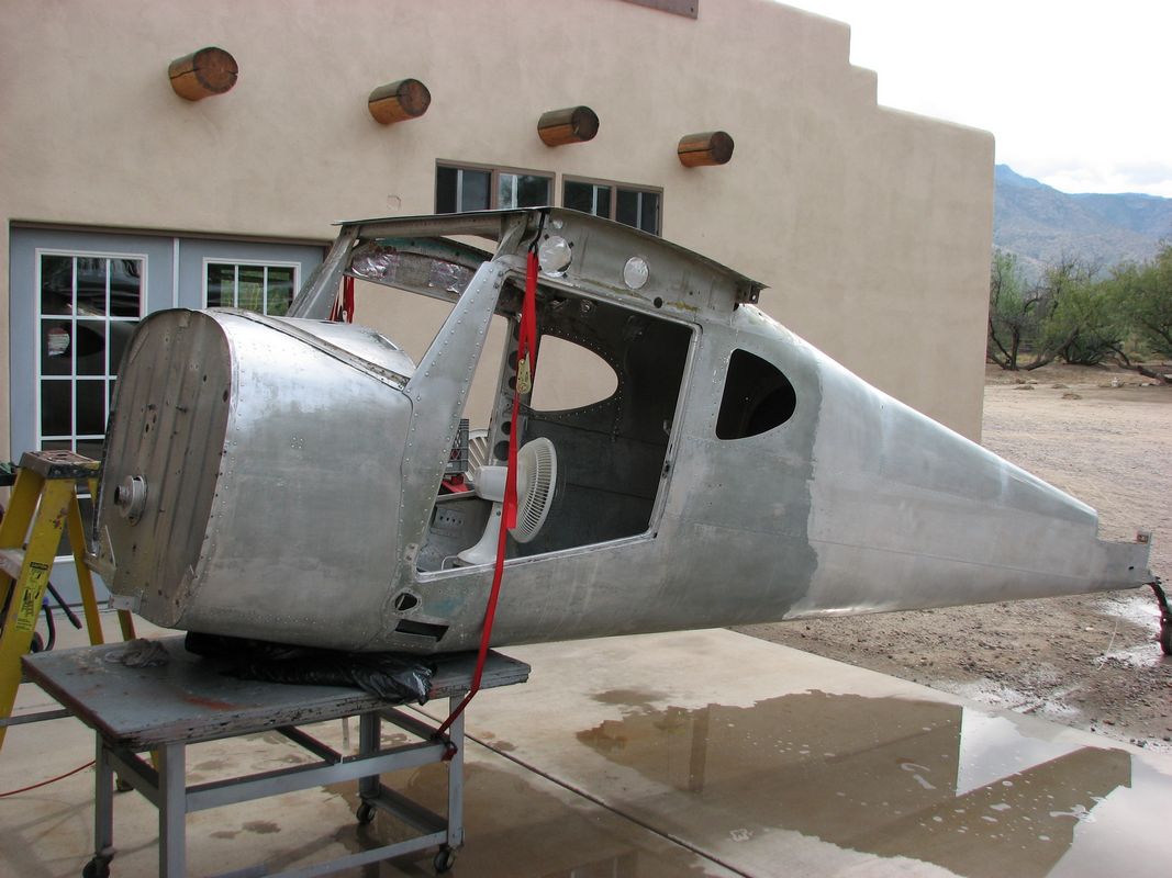

Thanks to all of you who responded to my earlier post regarding the sag in my landing gear. I've decided to go ahead with removing the gear legs and sending them in for repair. My question to those who might have done this, is what is your suggestion for supporting the plane with the gear off? Also, there is a company in Seattle, North Sound Aviation whose specialty is spring steel gear legs. I understand that this is all they do... Anybody have any experience with them?

I used the ol' Redneck way. Some sandbags under the main gear box on a roll around table so I could move it around. :lol:
