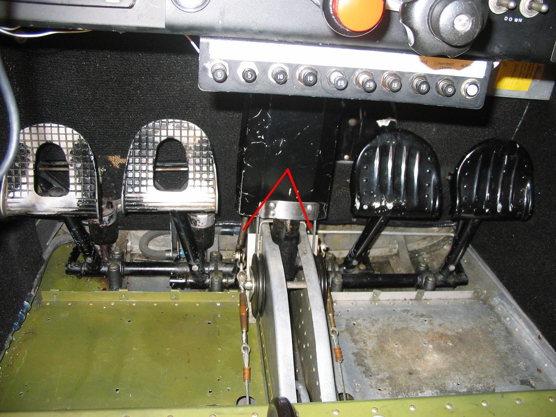

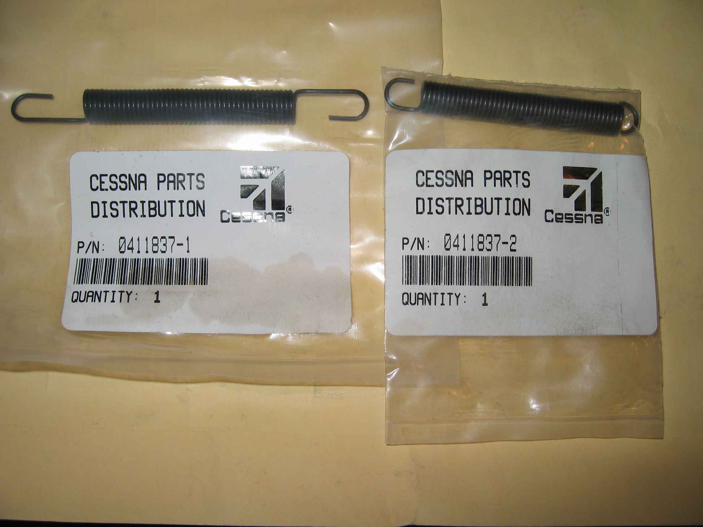

Oh my, yes you are supposed to have those rudder return springs. Here's a few pics, they are side specific. I wonder how your pedals aren't just flopping backwards. All models, even the 140A.

Yes, those springs are the only thing that tensions the rudder cables, unless you are pressing both pedals.
Incorrect adjustment of the cable lengths is known to cause problems with unintended brake application.
The only adjustment is the distance of the pedals from the firewall, six inches, measured from the hinge line of the pedals.

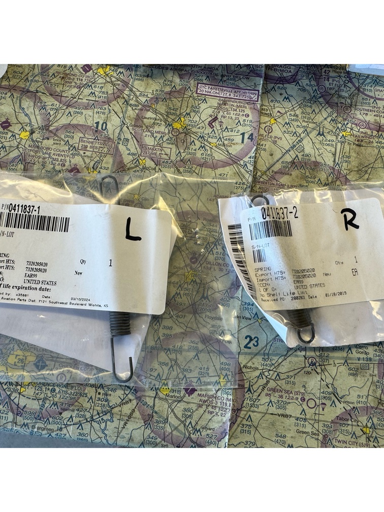

Take note of the springs, they are not the same! If I recall correctly, one of them is not easy to replace. One of my final approach checklist items. HEAT and FEET. Carb heat and heels on the floor!

I’m in the process of replacing my springs now. The right-side spring was on back order, it took two months to get then.
- Rudder return springs

Turns out there are springs, but the same spring non both sides. I have ordered new ones. There is an adjustment on the pedal to brake hook up. My mechanic is going to see if that might help. I will have him measure the distance between the firewall and brake pedal hinge line, that could be the problem. Thanks for all the good ideas. Frank
