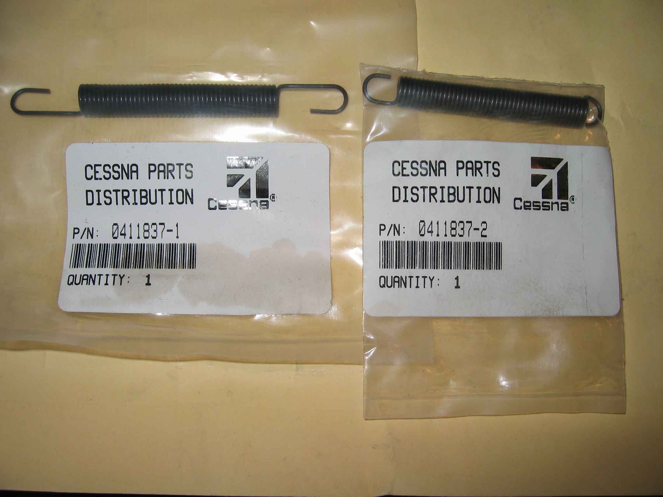

I recently purchased a 1948 Cessna 140 and am having issues with the brakes being applied when I move the rudder pedals, both taxing and takeoffs and landings. I owned a 1946 Cessna 140 back in 1984 through 1989 and never had this issue. I have big feet but have been making the point to only moving the rudder pedals with this tips of my toes. Looking at the Cessna 140 parts manual, I see there is suppose to be rudder/ brake return springs on the rudder assembly. My aircraft does not have those installed. I am wondering if they were not installed on 1948 model 140s? I am also wondering if those springs would normally pull the rudder pedals and brake mechanism further back, thereby preventing the problem I am having? I have experience with Cessna 140s, 180s and L-19s and have never had this problem. Any ideas?

Oh my, yes you are supposed to have those rudder return springs. Here's a few pics, they are side specific. I wonder how your pedals aren't just flopping backwards. All models, even the 140A.

Yes, those springs are the only thing that tensions the rudder cables, unless you are pressing both pedals.
Incorrect adjustment of the cable lengths is known to cause problems with unintended brake application.
The only adjustment is the distance of the pedals from the firewall, six inches, measured from the hinge line of the pedals.

Take note of the springs, they are not the same! If I recall correctly, one of them is not easy to replace. One of my final approach checklist items. HEAT and FEET. Carb heat and heels on the floor!

6277 wrote: ↑Sun Aug 18, 2024 8:22 am Take note of the springs, they are not the same! If I recall correctly, one of them is not easy to replace. One of my final approach checklist items. HEAT and FEET. Carb heat and heels on the floor!
I’m in the process of replacing my springs now. The right-side spring was on back order, it took two months to get then.

Turns out there are springs, but the same spring non both sides. I have ordered new ones. There is an adjustment on the pedal to brake hook up. My mechanic is going to see if that might help. I will have him measure the distance between the firewall and brake pedal hinge line, that could be the problem. Thanks for all the good ideas. Frank
