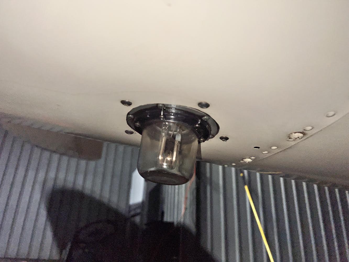

Hello all. Our 120 has a white strobe light installed on the belly, finally looking to upgrade to a red LED beacon light. According to the logbook it is an FS 4400 unit, would anyone be able to offer an easy LED replacement?
- IMG_9122.jpeg (136.89 KiB) Viewed 5224 times

Looks like it might be a Universal FS 4400. Your log books should say exactly what it is.
To convert from strobe to LED you will need to replace the entire unit. To do so shouldn't be a big deal; they all mount about the same way.
Does it still work? If so, you may be able to sell it and recoup some of your expenses.

Thanks, just confirmed with the logbook it is a FS 4400 unit, if there is a direct replacement I would certainly be all over that.

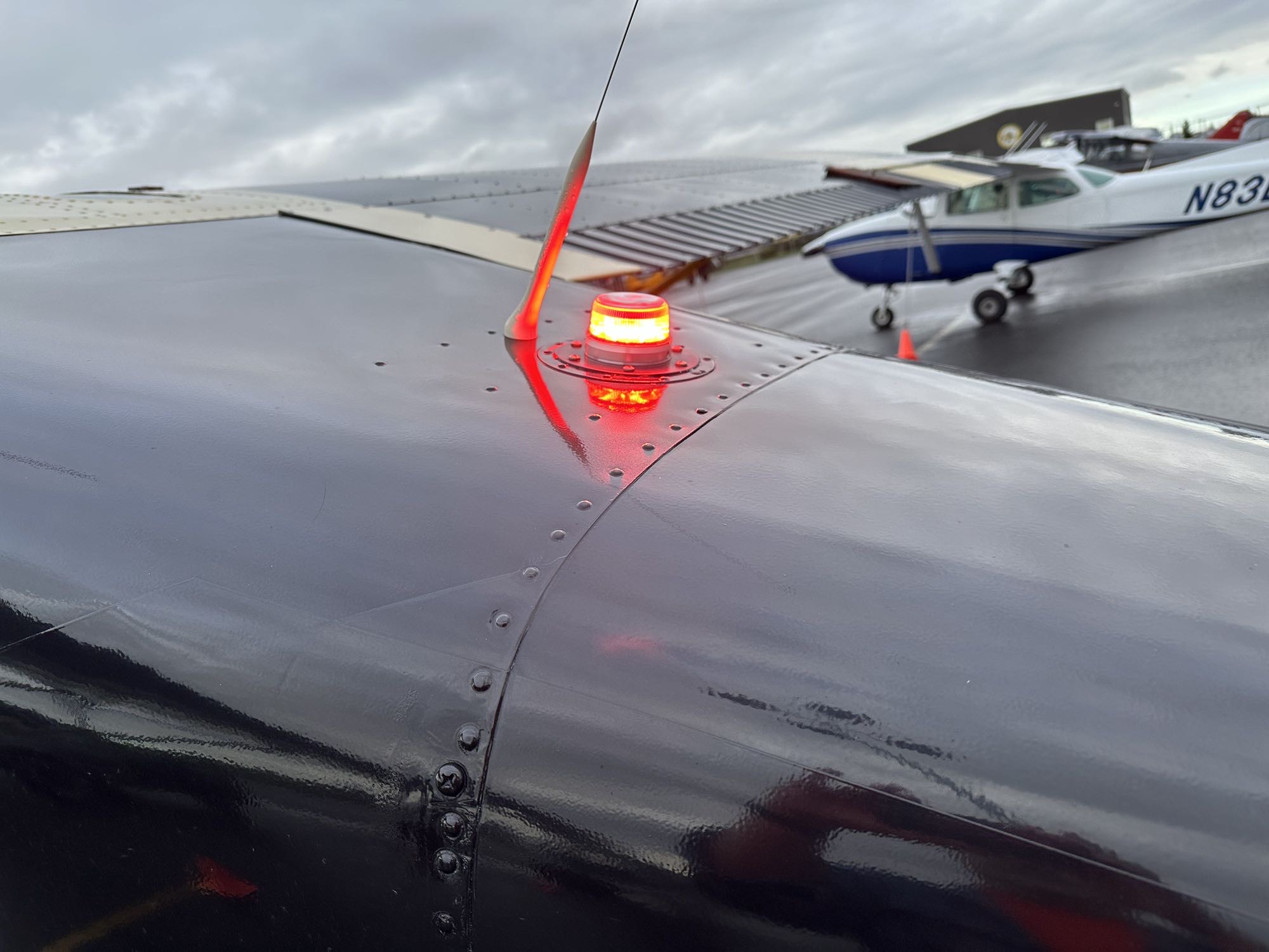

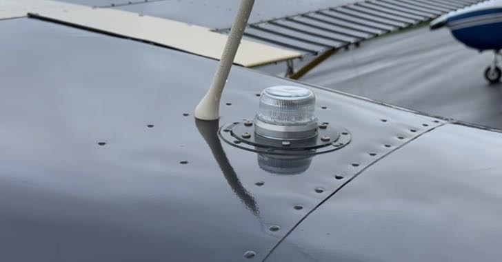

Replaced our FS 4400 unit with a aeroLED beacon pretty easy swap.
- IMG_2212.jpeg (32.02 KiB) Viewed 3678 times
- IMG_2211.jpeg (292.85 KiB) Viewed 3678 times
