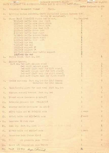

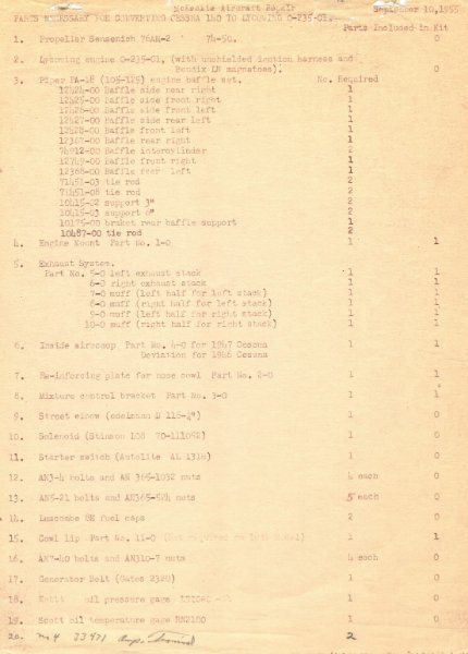

I found this tucked away in 79 years of my 140's documents. Parts list for the McKenzie O-235-C1 conversion. Still can't find a copy of the associated drawing (L149-0600244). If anyone knows where one is, let us know.
Thanks,
Ed
