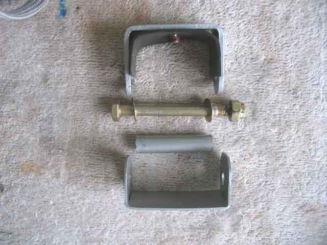

The retainer looks all wrong, that gizmo that wraps around the springs. It should look something like this.

The main spring should be flat in the area where the gap is showing. I'm not sure if the different thickness leaves (maybe an illusion) are correct. As mentioned, the retainer is all wrong.
Read the Neal Wright articles, then go through the whole setup. The main leaf can be purchased separately. Stick with what you have; do not get one with the "double bend".
