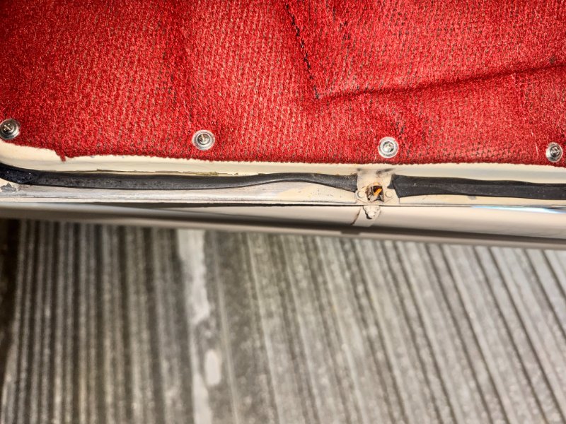

Wondering if I could be pointed in the right direction for the correct door seals to purchase for a 120 door, picture attached. Also looking for the best adhesive to use and general advice for this project, thanks.
- IMG_9620.JPG (146.25 KiB) Viewed 4029 times

I found that my door didn’t have consistent gap all the way around so went to a box store and bought several profiles of rubber seals. I used different profiles on the sides from the bottom. Used 3M 6600 and it has held up for 2 years. Make sure everything is cleaned well with mineral spirits.
