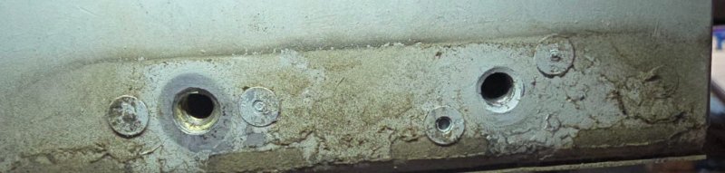

Anyone know what size these little nut plates are for the flap hinge bolts to screw into? Thanks

atypicalguy wrote: ↑Sun Feb 16, 2025 3:21 pm Anyone know what size these little nut plates are
AN366F-1032

Thank you. One wing doesn't have any! Looks like the other might be cherry max or similar.

6643 wrote: ↑Sun Feb 16, 2025 4:08 pm
AN366F-1032
Ok so Univair has them superceded by MS21047-L3, which seems to not have an elastomeric lock, but rather is all metal. I seem to recall people not liking nylock hardware for these blind applications, as they are only good for a few uses. So I will go for the metal ones I think: https://www.wicksaircraft.com/shop/anch ... g-ms21047/

How often are you going to take the flaps off?
AN366F-1032 supersedes to MS21078-3
Oddly, if you look that number up on Univair's web site it shows a Luscombe tail bulkhead, which includes one MS21078-4...
