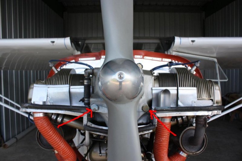

Pre-oil thru your main oil galleries, look for these plugs

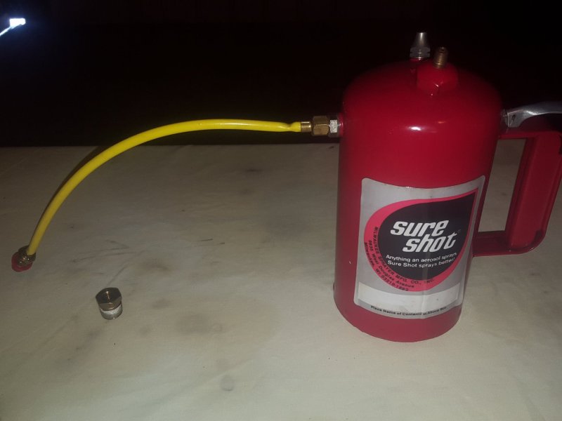

I made a presssure device to force oil into the galleries on both sides, it should also prime the pump some. I pulled the oil pressure line at the firewall to make sure oil was coming thru. I did this prior to my first run on my fresh overhaul.
