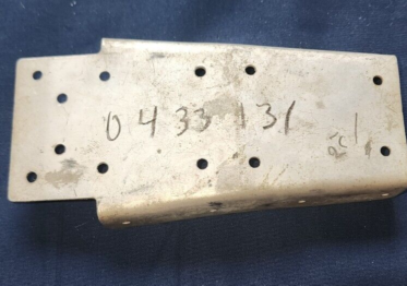

These are the only 2 'rudder' AD's I know of, you can look them up in the member's resources or the FAA website
51-21-01 CESSNA: Applies to Models 120 and 140 Aircraft, Serial Numbers 8001 to 10650, Inclusive, and/or Any Other Serial Numbers Not Having Steel Reinforcing Channel, Cessna P/N 0433131 or Equivalent Installed.
Rudder ReinforcementSmall.png (151.53 KiB) Viewed 17882 times
46-44-01 CESSNA: Rudder Stop Bolts /CESSNA SERVICE LETTER SLN-02
SUBJECT: Removal of Rudder Stop Bolts
