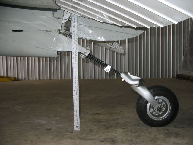

Posted: Mon Sep 03, 2018 6:31 pm

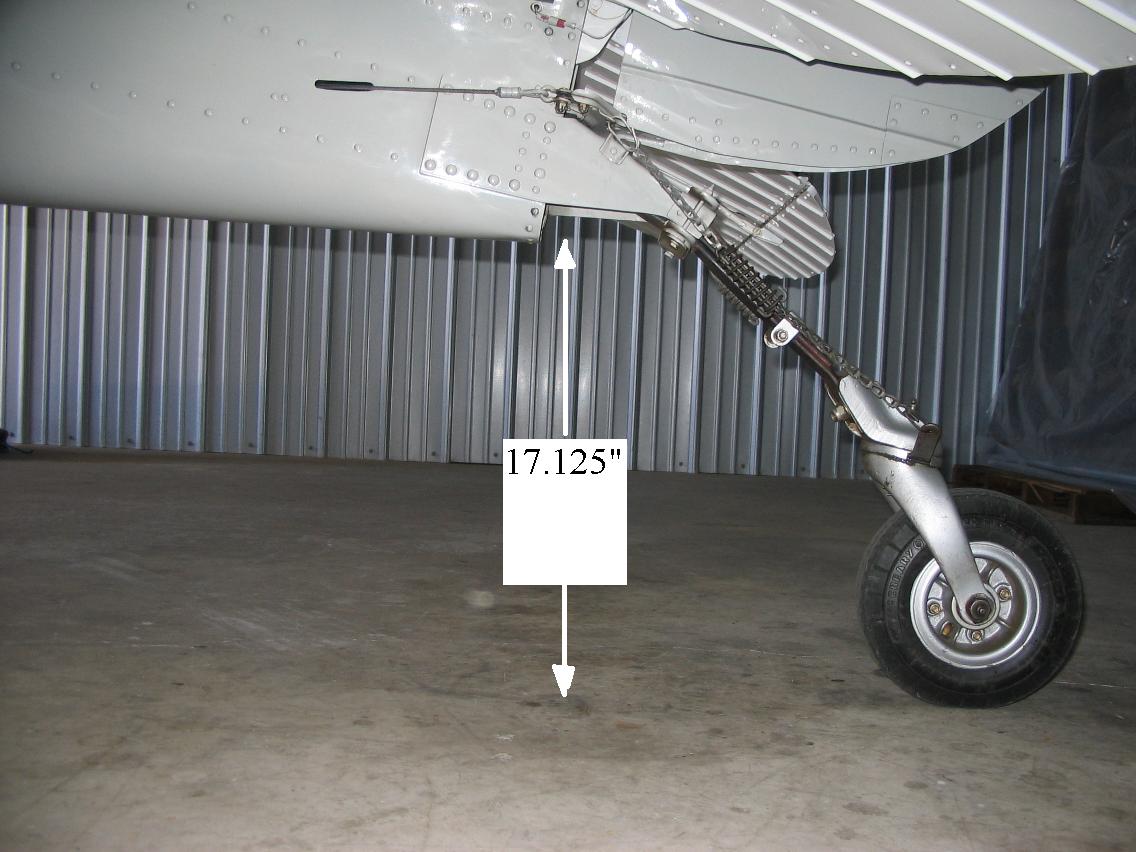

My 'double bend' spring set on my early serial# bird...

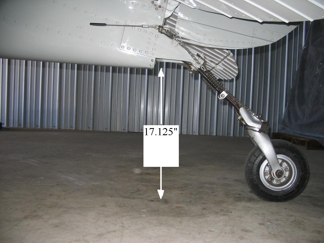

My correct 'single bend' spring set on my early serial# bird....

I ordered 05-07055 for my 1946 sn:9168 and it is the good match for the Scott 3200. As per 6597 second picture we can see that Scott table is parallel to ground, which is the best setup.
