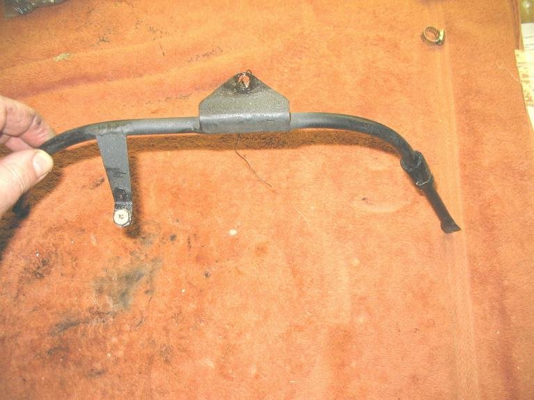

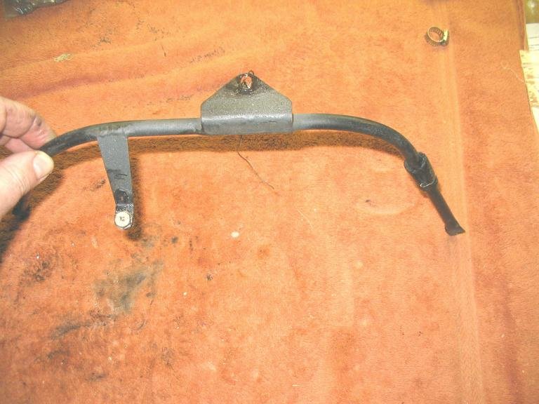

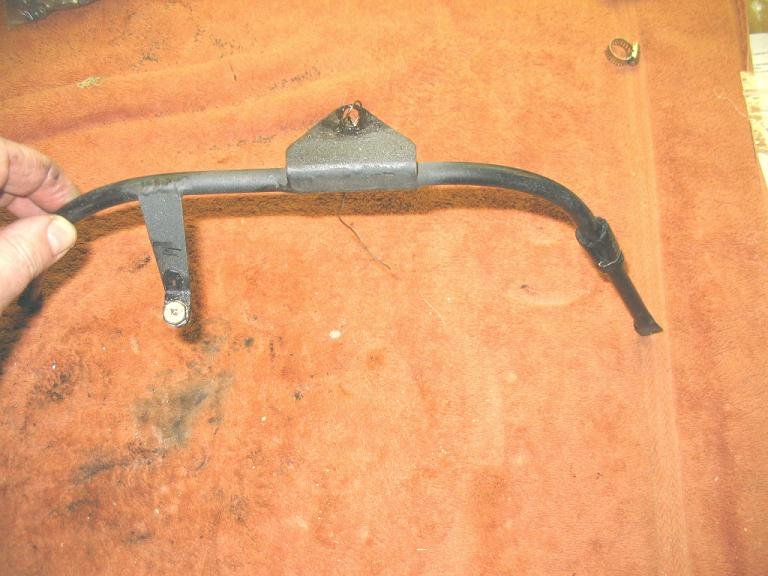

Chief Aircraft had what I needed a few years ago when I had to replace my LH C-150 muffler. I had all the other bits like heater shroud and tailpipes, which Chief seems to have also. I am assuming you will perhaps contact Ken and Lorraine Morris who have the active STC for the 150 exhaust installation? Crossover brace pics below, attached to a stud on the oil tank and by straps on the exhaust down spouts.
https://www.chiefaircraft.com/wc-8300-3.html
https://www.chiefaircraft.com/wc-8300-4.html
