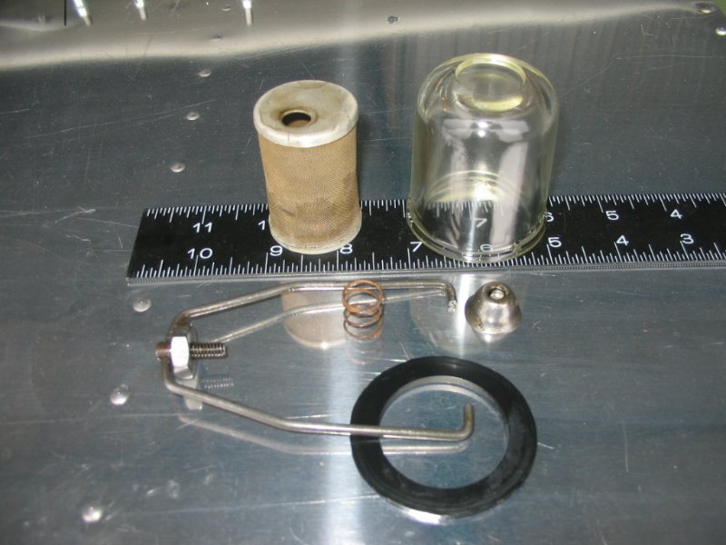

It appears to be about .5" wide by about .75" tall give or take, here's what I have in mine, it's sole purpose is to keep a little pressure against the screen from on top of the glass bowl-

Thats perfect information for the spring, thanks David so much , and Im guessing that the slot offset in the standpipe is where a piece of the bottom of spring sits to hold it that way at bottom which would then center the top of the spring at the bottom of the glass? Or does it encircle the standpipe? Thanks Jim my filter is actually decent but thats also good to know, I was concerned about the spring holding that filter down.

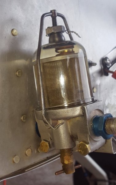

Good question, here's what I've been doing for 30 years, just copied the last guy. Hope I got it right! Spring centered on standpipe...

Yes David so as in your picture, I have seen evidence of the spring from pics of filter tops and wear, that it appears from the wear marks on the top of the filters that some people had them around the standpipe such as yours , and others had them half circle through the standpipe cutouts that I am guessing would center the spring more in the centre of the bottom of the glass in the inside for a more even pressure , it looks like I will do some homework when I take it apart again to replace that missing spring. Great pics thank you.

That spring presses the bottom of the screen against the gasket and is critical for preventing water and unscreened (I hesitate to use "unfiltered") fuel from getting to the carburetor.
