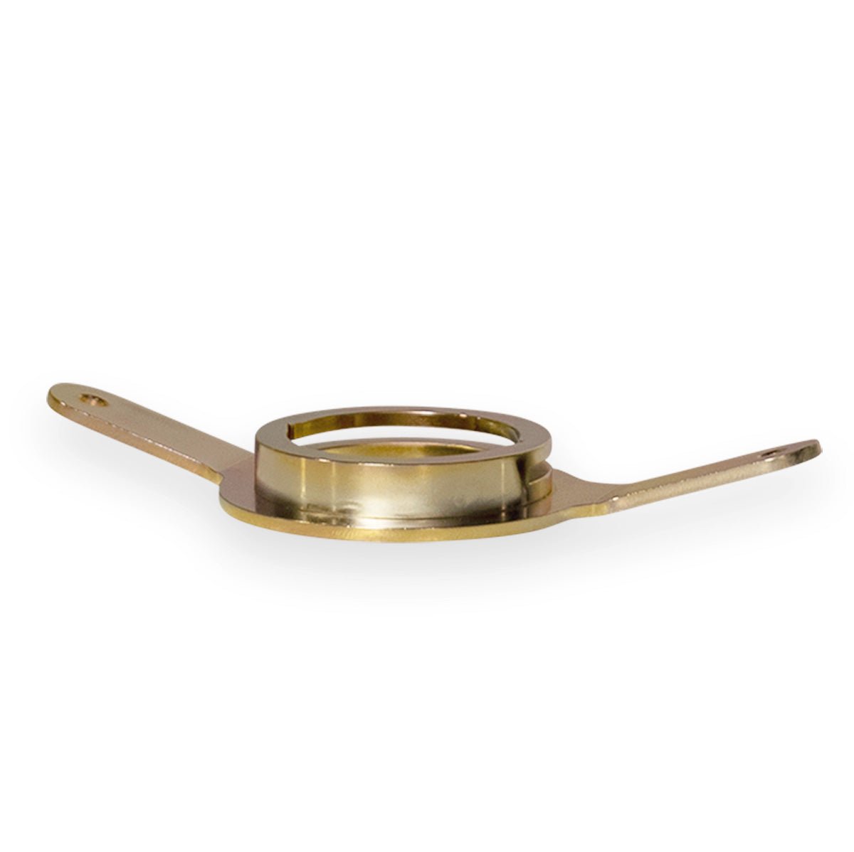

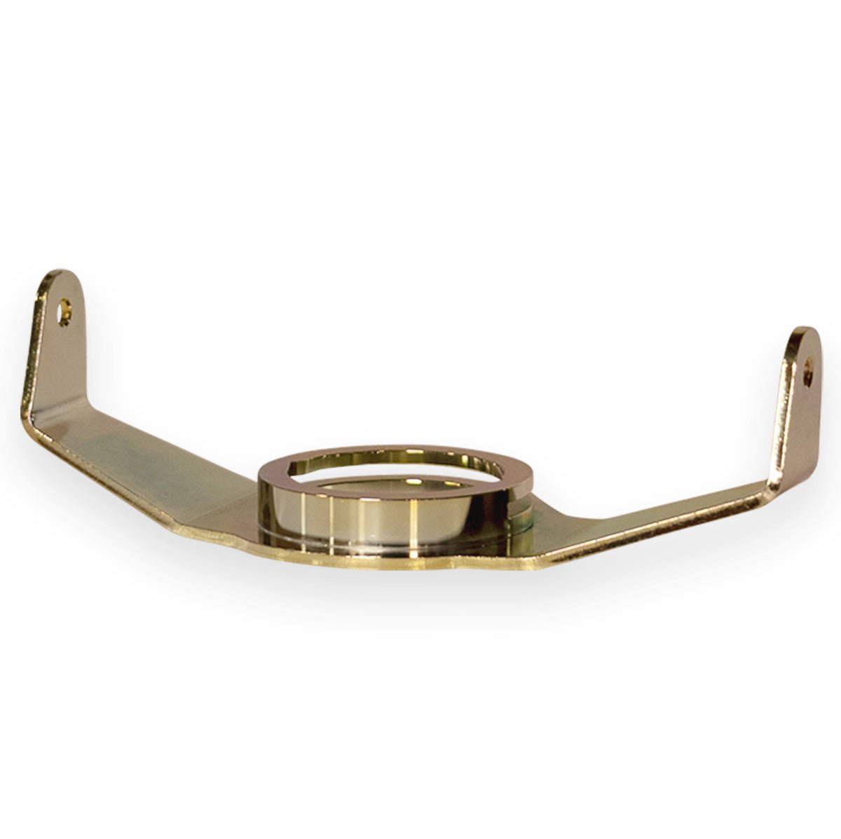

I think you are misinterpreting the pictures. None of the pictures in that file show the arms with the bent tips. What you are seeing is the arms which are not exactly flat. On the 3200 the complete arms are slightly bent at the base whereas on the 3400 the tips of the arms are bent vertical.
Univair lists the ABI-3224A as an approved replacement for the 3200. It has the "heavy duty" bent arms. I'm pretty sure that when it was Scott the only wheels with the bent arms were the 3400 series, which was not an approved replacement for the 3200. (The 3200 is the approved part for the 120/140.)
None the less, the TCDS lists the Scott 3200, and when it was written, the 3200 had the "straight" arms. Why argue with success?
"Straight"
"Bent"
