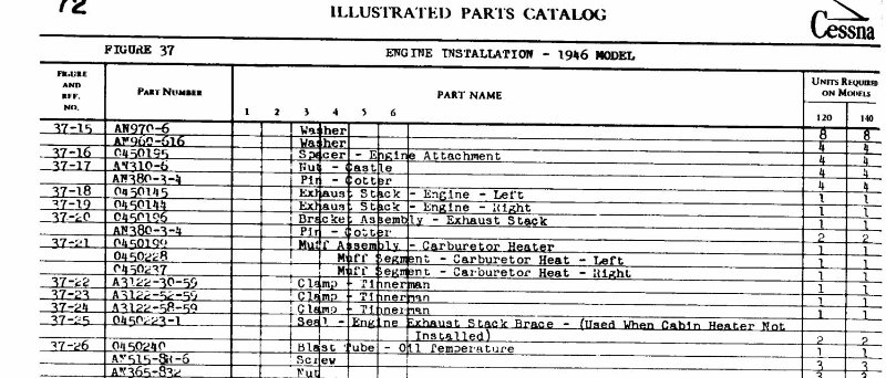

My parts manual sez the '46 birds had a blast tube, here's a screen shot of the page, see 37-26. There's a Neal Wright article on how to make a simple alternative, and I recall an article somewhere that someone used lawn chair tubing to make one.
https://www.cessna120140.com/Forum2018/ ... ?f=10&t=99
I don't recall the dynamics for needing a blast tube on the oil temp sensor housing.

6597 wrote: ↑Tue Jul 15, 2025 4:17 pmI don't recall the dynamics for needing a blast tube on the oil temp sensor housing.
It cools the oil!
All the oil passes through the oil screen housing. Buried in the center of that oil is the temp sensor. If the gauge reads lower it's because the oil is cooler.
The C90 is supposed to have the 5 quart tank and baffle, and the blast tube. It's also supposed the have a lip on the bottom of the lower cowl to decrease the pressure in the lower cowl, and increase the airflow through the cowl.
