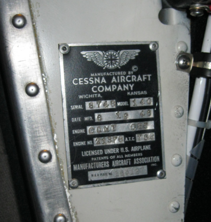

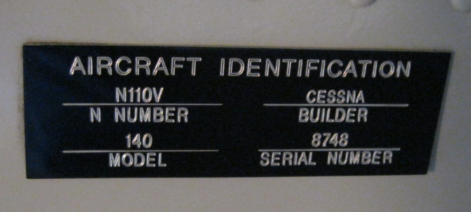

This is what goes under your stab on the left side of the fuselage...
This is what goes on your inside left door post, or up on the dash depending on year. Getting a new one of these is not easy, you should have had one all along if you have been getting your plane annualed...

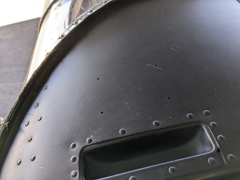

Here is the location on the glare shield. You can make out the four drilled holes.
If its not under all the glue and vinyl then replacement process will start with your FSDO. You will need to get an airworthiness inspector to come see the airplane and documents. They issue a letter requesting Cessna to provide you with a replacement data plate. That's when you really get your wallet reamed out.

I apologize for sounding negative about this subject, but this issue could potentially be a very bad situation for you, since technically, an aircraft without a manufacture’s supplied data plate (in this case Cessna Aircraft) is considered by the FAA to be unairworthy. That plate on the rear of the fuselage that you’re asking about is not the required manufacturer’s supplied data plate (see pictures from previous posts) that was attached to the airframe when the aircraft originally received it’s certification at the factory. The rear ID plate is installed per a later regulation, CFR 45.11, which details identification marking of aircraft. Section (e) of the regulation (CFR 45.11) covers aircraft manufactured before 7 March 1988, and since the 140/120/140A aircraft series were manufactured before that date, the owner or operator must attach identification as detailed in section (e) of the regulation utilized in identification purposes for law enforcement, FAA, and TSA situations.
