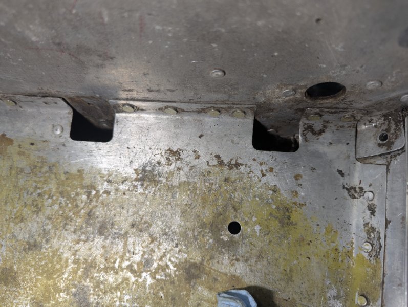

I am restoring N72622 (1946 C120 #9798) and trying to decide how to get all the collected grime and dirt out from under the floorboards and install a new battery cable. The only access seems to be these little holes.
Does anyone have a better idea for how to get in there?

Wellllll............... I feel your pain. I was in the same place years ago.
I determined it was easiest to just un-rivet the floor boards, and that makes it much better access.
Why..........Why!? Cessna decided to run the battery cable under the pilots floor board we'll never know.
The floor boards are suprising "easier" to un-rivet then replace.
Best advice I can give, It's almost impossible to accomplish your two tasks with the floorboards in place.

I agree with Victor. There's really no other way to do a good cleaning.
I think I recall using a ball peen hammer as a bucking bar down inside the gear box...

I got those floorboards out and there was SO MUCH gunk under them.
Re: Floorboard cleanout
Posted: Tue Sep 09, 2025 7:09 pm
chriscrewdson wrote: ↑Sun Sep 07, 2025 10:00 pm I got those floorboards out and there was SO MUCH gunk under them.
That............!! is an impressive amount of "Gunk". You win the award.....and not the one you probably wanted to win! ;)
