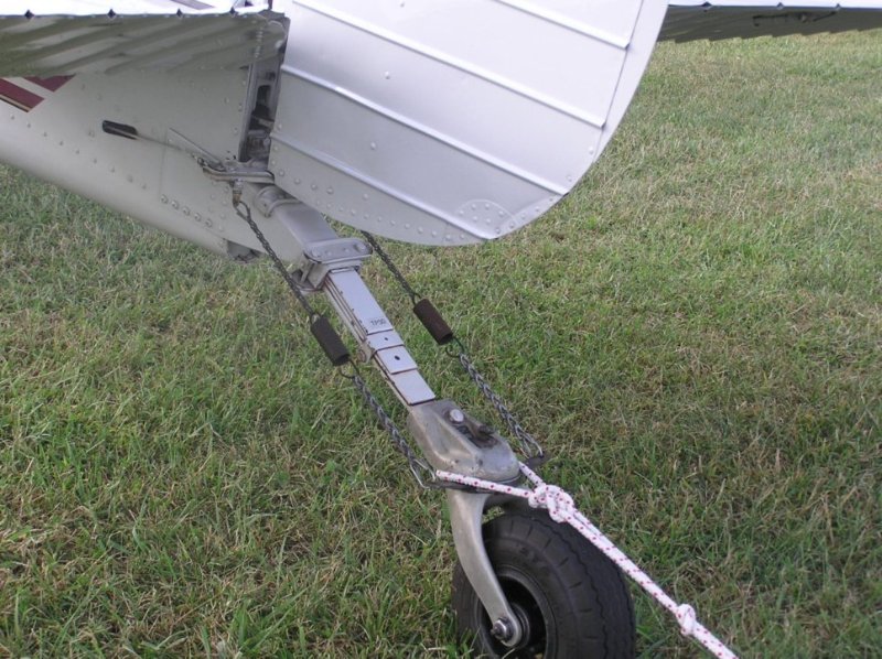

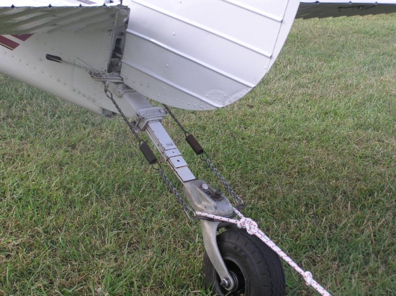

Here's a pic of what the tailwheel bracket looks like, with a variety of fasteners. They are supposed to be rivets but over time folks have used bolts or a combination. The stabilizer/fin/rudder need to be removed to replace the tailwheel bracket properly.
There is damage on this rudder from most likely the tailwheel spring having failed and things popping upwards.

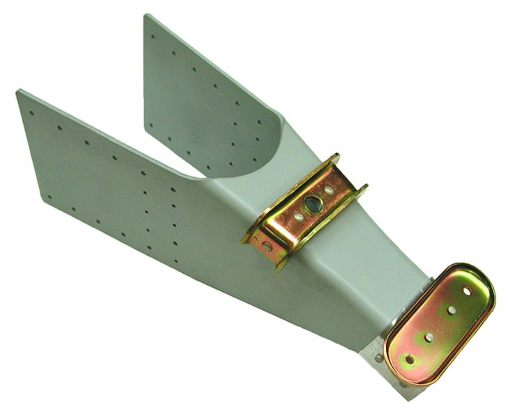

Posted: Sun Sep 28, 2025 9:42 am
OK, I had to take your last picture and blow it up to see a small repair patch above the tailwheel bracket, but the first 2 pics are just straight forward tailwheel brackets that are attached with nuts/bolts. This tailwheel bracket is supposed to be held on with rivets but your pics show nuts/bolts, not ideal but what folks do. I don't know about legalities. Here's a pic of a 'fresh' tailwheel bracket from Univair. They get dinged up over the years, cracks etc from bad landings. You absolutely have to remove the stabilizer and fin/rudder to put on a new one. If the one you are looking to purchase does not have any cracks or otherwise appears to be servicable then maybe you are OK, others on the Forum will chime in shortly.
