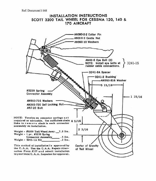

I wonder why the official Scott install says AN7-20 (a drilled bolt) but also says to use the 365 self locking nut....
I'm guessing the nut that holds the spring stack together in the front finally gave up the ghost. I check that on every pre-flight. Don't ask me why...... :roll:
Re: Maule Tailwheel Failure / Scott 3200 Replacement Parts
Posted: Fri Oct 10, 2025 4:14 pm
I would use a -20A bolt.
Posted: Fri Oct 10, 2025 5:52 pm

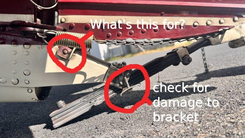

I use and undrilled -20A and a metal locking nut AN363-720
Scott tension springs used on your Maule?
What is that mounting angle piece for that I circled.
Check for cracks on your tailwheel bracket where the springs pivoted.
Posted: Fri Oct 10, 2025 6:11 pm
The "what is this for" is the bracket the bolt passes through.
Good grief, senior moment on my part...
