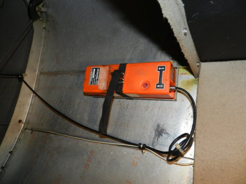

by 8061
Maybe not the best install but was simple.
Re: Looking for install pics 406 ELT's
Posted: Thu Nov 06, 2025 9:27 am
That does look simple. I do use the baggage area quiet a bit though so I might have to make a cover for the ELT. I've got a space/cover where the glove box was for the remote, hadn't thought of the buzzer being next to the remote, loud but not a bad idea and simplifies the wiring a little bit more with a 4 conductor wire.
The regs on new 406 installs want them on more structural bearings, my hat rack is not 'structural' enough. Wish I could figure a route behind the baggage compartment. My old unit location doesn't work anymore. Currently using AC No: 91-44A Change 1 for guidance and the Artex install guidelines for ideas. Pretty limited.

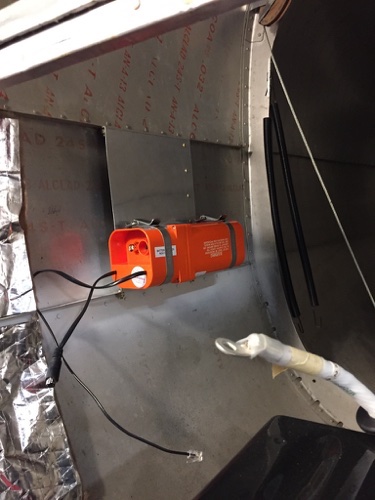

by 8342
Here is how I mounted one in a 140.
Posted: Fri Nov 07, 2025 8:03 am
That image is pretty small and blurry, is it on the right side ahead of a bulkhead? Can't tell for sure...

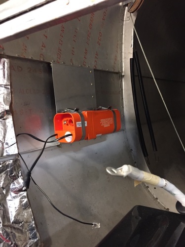

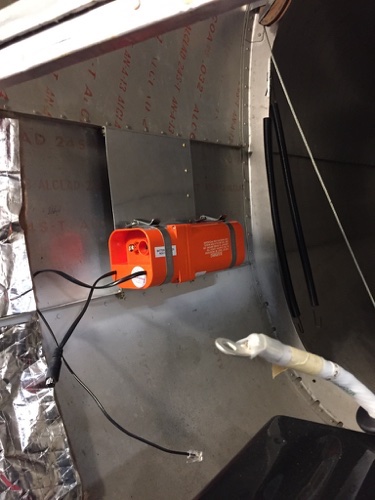

by 7896
Here are a few from my install.
Posted: Fri Nov 07, 2025 3:10 pm
That's the route I really want to take but the current requirements say not to attach to 'skins' on new installations. I think the reasoning is that there is too much flex or movement that sets off ELT's. Never mind that my current ELT is 'skin' mounted and in the last 30 years I haven't had an inadvertent set off.....

by 8342
My installation is not mounted to the skin, it is mounted to the stringer.
The same as Michael.
Posted: Sat Nov 08, 2025 9:39 am
Mine doesn't have a 'stringer', it's simply a bend in the skin to make a lip. The lip is part of the 'skin' so that's why I'm hesitant to install where the existing Sharc7 is with a plate like you two...it's such a perfect location.
