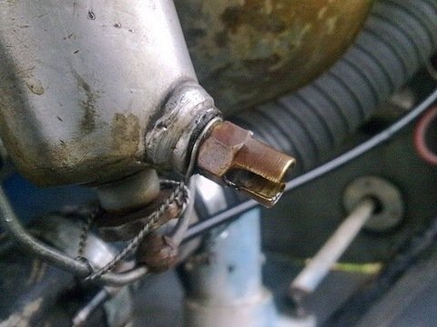

Are you sure? It thought the ones with square seals were the Curtis valves. I also thought the reason they stopped selling the seals was because there was a rash of failures when the little washer that was peened onto the end to hold the seal came unpeened and the valve core was ejected.
Curtis drain failure.jpg (35.75 KiB) Viewed 3318 times
