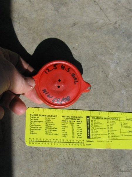

I have a 1946 model 140, and in discussions on fuel caps, I've never seen this exact style pictured online, I'm curious about the nuances of these caps in relation to other discussions speaking to providing the correct amount of venting to allow for fuel flow.

That is not one of the caps addressed in the discussions. I'd be very cautious given it carries the word "vacuum" stamped on the edge.

gbeard76209 wrote: ↑Sat Nov 29, 2025 9:48 pm I have a 1946 model 140, and in discussions on fuel caps, I've never seen this exact style pictured online, I'm curious about the nuances of these caps in relation to other discussions speaking to providing the correct amount of venting to allow for fuel flow. :D
Photo is a non-vented automotive fuel cap. Ford/Lincoln/Mercury. Search E1AZ-9030-A
So definitely not appropriate.

dcannon wrote: ↑Sun Nov 30, 2025 8:15 pm Photo is a non-vented automotive fuel cap. Ford/Lincoln/Mercury. Search E1AZ-9030-A
(Somewhat tongue in cheek...)
Well, if you think the official Cessna caps weren't also used in an automotive (or more likely, farm tractor) application, then you're fooling yourself!
Might not be appropriate haha, thats crazy to find out, at least they're from Ford am I right? This airplane is new to me, and as far as I can tell by looking at pictures, the fuel caps have been this way since the 80s. It seems that the hole in them was drilled, similar to what other fixes suggest for replacing the incorrect ones, so not entirely non-vented.
