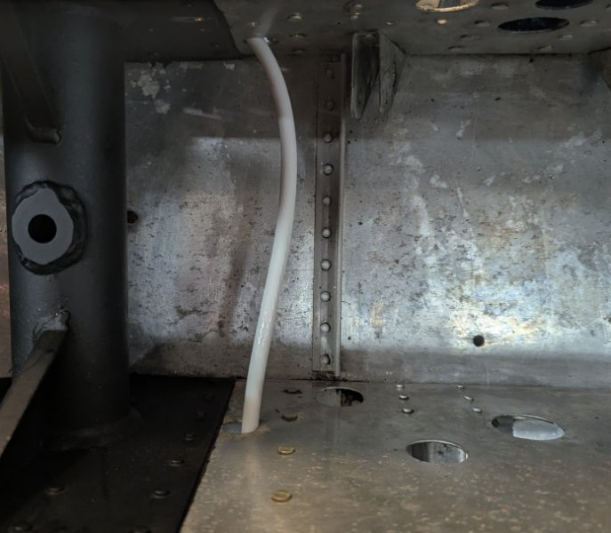

I am routing a new 4GA wire (M22759/16-4-9) to the battery and I am trying to figure out how to protect the cable during its travels through the bulkheads.
Should I use something like AN931 Elastic Grommets? Or some kind of wrap?
Here's the cable going through the gearbox.

I would say yes Chris, there are supposed to be AN931 grommets in those holes. Check the 120/140 parts book in the documents section of the main web page. Figure 18 does show the AN 931-7-11 grommet used in several locations in the bulkheads. My 140A uses the same to protect the battery cable running through the bulkheads.

i have grommets and the cable is wrapped in a plastic sheath of some kind.

For something like that I prefer "tracks". Or Grommet edge seal.
https://www.aircraftspruce.com/catalog/ ... kkey=21018
Basically a thin plastic serrated edge protector. Radio shops use it all the time, I feel it protects long term better than grommets. Also.......you don't need as large of a hole and usually easier to install with the wire in place.

Good point Victor, I forgot about those. It’s a shame those probably weren’t available when these aircraft were being manufactured many moons ago.
