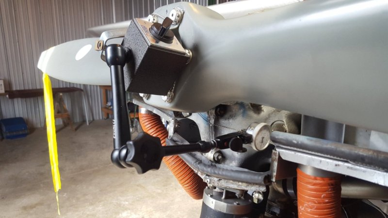

Fore/aft limits
Crankshaft to Thrust Washers Service limits .025
Here's how I measured mine when I had a concern
