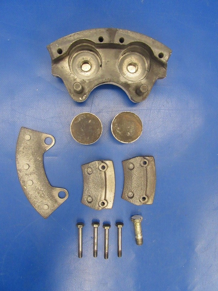

I've searched with no luck... anyone have a field approval for the install of double puck brakes on a 140? Perhaps 199-62 kit?
Thanks!

Question, do you have a set of Cleveland wheels and brakes with 30-52N brake assemblies already, and you want to install them on your Cessna 140? Typically 30-52 units are utilized on larger Cessna 180,185, and 206 series aircraft. Cessna 120/140/140 series converted to Cleveland units normally use the Cleveland 30-63A brake units with the 40-97A wheel assemblies. Cleveland 30-63A units have (2) two brake pads per caliper.
Just curious.
You can call Cleveland's customer service line at (800) 272-5464 and inquire. I've found the Cleveland folks to be very helpful.

The 30-52 is a double puck. The 30-52 is not on the Cleveland approved list for the 120/140's as far as I can see on their website. I know the big tire back country guys like double pucks. (EBay pic)
