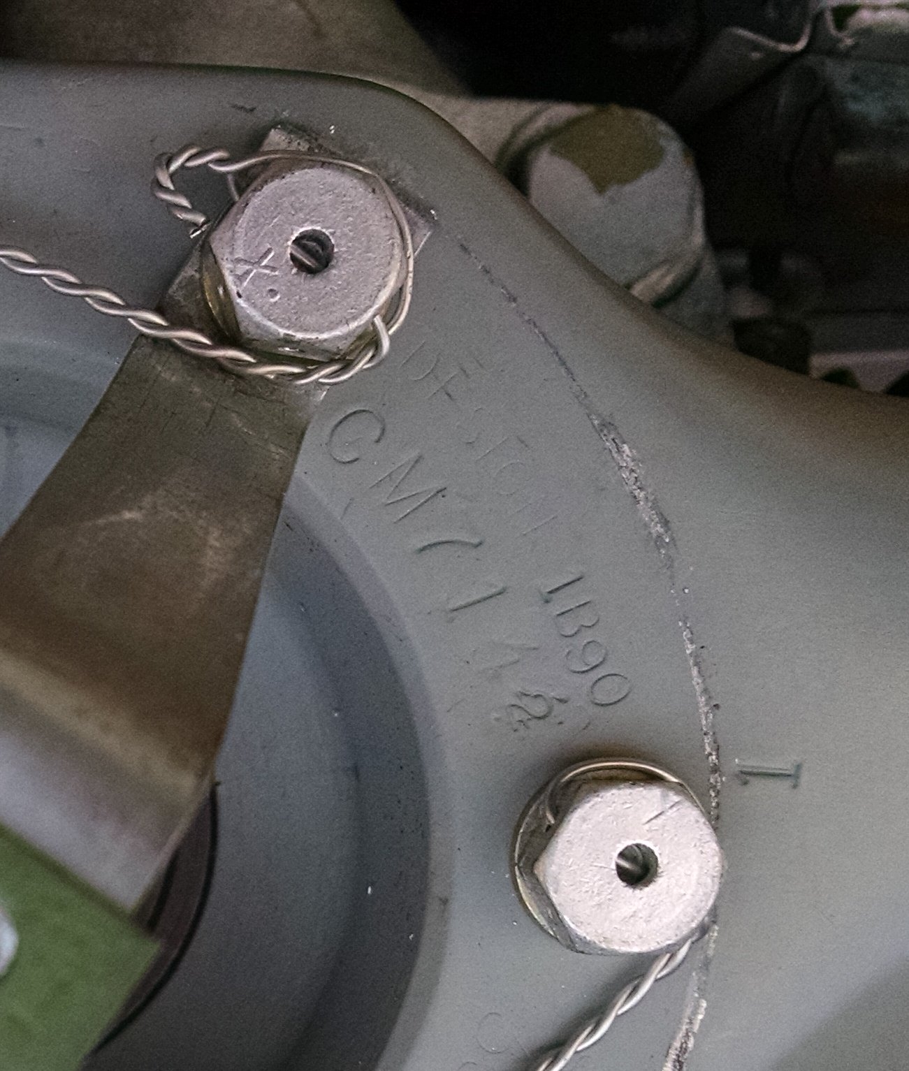

by hotrodmac
According to my logbooks, I am. Static is around 2250. I’ve never had the prop measured though, so can’t confirm it personally. I’m guessing @flybuoy already knows that about my airplane though. ;)
