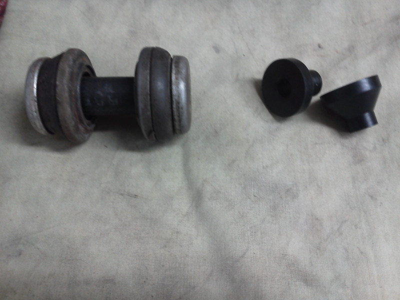

The -14 engine uses the same engine mounts as the O200, called "Lord Mounts". The -8 and -12 use the "conical" mounts. The Lord mounts extend back about 1/2 inch farther from the engine case than the conical mounts, so, unless you change the mount your engine will be about 1/2 inch further forward and interfere with the cowl. I'd be interested to see how your installation accommodates the difference.
The additional tube in the 0451111 is to accommodate the additional power of the O200.
Lord mount is on the left.
There are adapters you can get to allow the -14 case to use the -12 conical mounts. Their airworthiness is questionable... I would say a field approval would be required.

I suspect you may do more damage than good by trying to find a "conversion" isolator. I realize the cost of the new mount and the Lord isolators are substantial, but not having good isolators, that properly fit and support your engine could cost the price of an engine case (and complete tear down) sometime in the future. Personally, I wouldn't even consider it.

Photo three shows the adapters I was referring to. I recall that Don Swords had some sort of approval for them, but I could be wrong.
