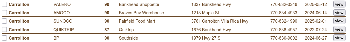

Ethanol gas stations in Carrollton GA
Screenshot 2026-04-25 at 19-47-10 Pure-gas.org - ethanol-free gasoline in the U.S. and Canada.png
Screenshot 2026-04-25 at 19-47-10 Pure-gas.org - ethanol-free gasoline in the U.S. and Canada.png (52.17 KiB) Viewed 5999 times
