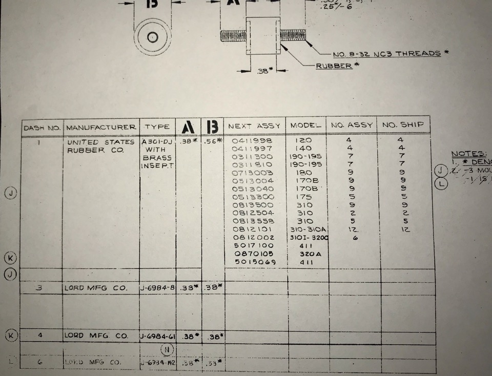

by 7633
An excerpt from the drawing detailing the effectivity and cross references.
Jeff

The design of the mount is the correct one but looking at the Cessna diagram in the parts book the nut is a standard UNC AN340-8 with a lock washer where as I was using a standard brass nyloc that is quite a bit taller I think and therefore takes more thread.
