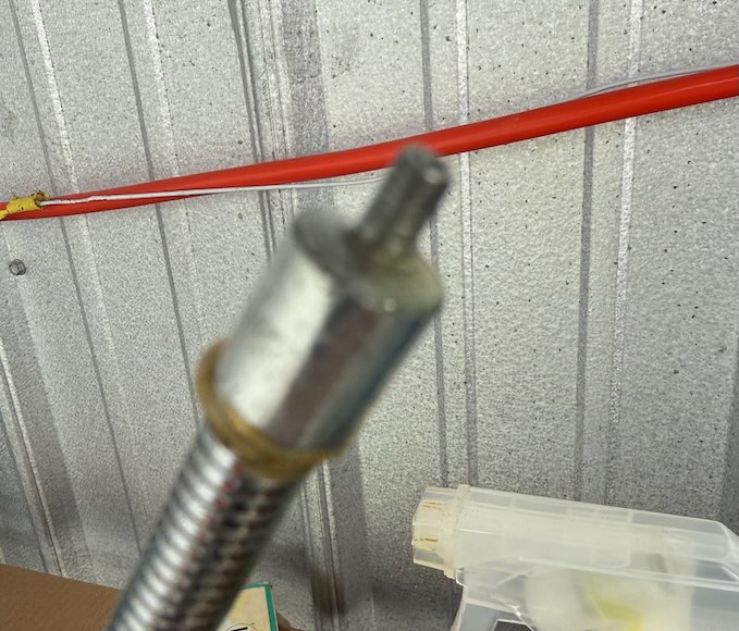

I found that if you have a pump oiler can with a tip as shown in the attachment, it is very easy to reagin prime. Simply remove the oil temperature bulb from the screen housing and insert the tip shown. Its OD is about the same as the bulb, so once inserted you can pump away and fill the screen and oil pump cavity easily. When you've pumped enough remove oiler, plug hole with thumb, and then quickly replace oil temp bulb. Oil pressure should come right up, and seems to work even in a three point attitude, though the amount of back flow on removal will be less if you first lift and support the tail.

Oil is Lubrimatic 50-337 available many places including Amazon
