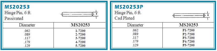

Posted: Sat Sep 12, 2026 11:44 am
Don't use a stainless pin in an aluminum hinge!
MS20253 Hinge Pin.jpg (52.61 KiB) Viewed 414 times

Why would low corrosion stainless not work in aluminum? I was thinking 304?
Re: Window hinge pins
Posted: Sat Sep 12, 2026 11:40 pm
by atypicalguy
Oh I guess the one I found at Spruce is passivated also:
https://www.aircraftspruce.com/catalog/ ... 9000-3.php
Posted: Sun Sep 13, 2026 7:32 am
atypicalguy wrote: Sat Sep 12, 2026 11:37 pm Why would low corrosion stainless not work in aluminum? I was thinking 304?
It's hard to explain in one paragraph, but metals have a property called "nobility" measured on a chart of "galvanic corrosion." Metals on one end of the chart (magnesium, for example) are prone to corrosion and on the other (stainless steel) are not. The issue is, corrosion is promoted based on the distance on the chart between the two metals in contact. So, magnesium castings with magnesium bolts would not promote corrosion, but aluminum in contact with stainless steel would. The aluminum corrodes at the expense of the stainless.
So, if your intent is to protect the pin, stainless is a good choice, but if it is to protect the hinge, cad plated is better. (Cadmium and aluminum are very close on the scale.)
