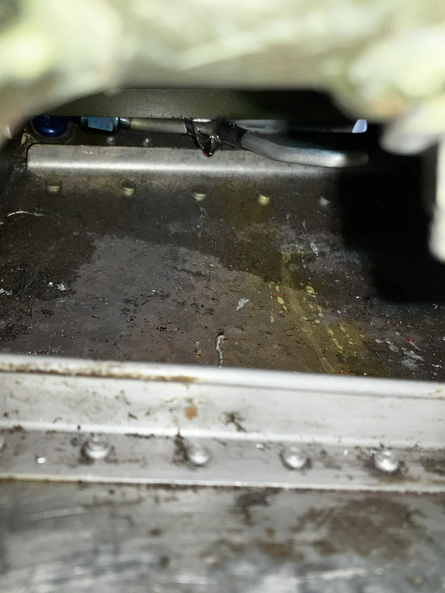

I need to replace this part, but I am not sure what it is supposed to look like. The current one doesn't look right. See the attachment showing the leak. The parts manual does not have a good description. I think it is a one piece that runs all the way from the flexible brake hose to the connection to the gear leg. Does anyone have a picture of one? Or better yet, does someone that is parting out a 140 have one that they would sell?
Roger
Left Brake Line - Part Number 0411797
- IMG_5474.JPEG (644.62 KiB) Viewed 151 times

Re: Left Brake Line - Part Number 0411797
Need to fabricate a new line. Spruce has all the hardline tubing (5052-O) and fittings. Search the forum, there are a few threads on the topic. Might be good to find a local A&P to help.
