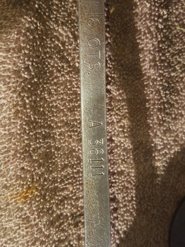

- Posts: 571
Re: Oil Cap and Dip Stick
Well those numbers on the SIL don't match anything I have. Mine is labeled for 6qt but when I put in 6qt and run it after an oil change it shows 5qt. I just live with it and keep it at 5qt. 0-200 with a 6qt tank. Number A36111 on the dipstick itself.
I did find an obscure article on dipsticks and sumps regarding Aeroncas. My number A36111 shows up in one of it's tables and is listed for 0-200's.
https://johnpropst.yolasite.com/resourc ... 20rev8.pdf
