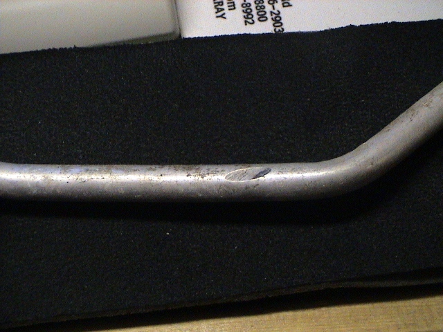

What I've done is remove the B nut at the fuel selector and draw the gascolator forward to get at the Gascolator mounted fuel line.
Yes. And the fuel line can be damaged by the elevator pushrod if it is not put back in correctly, here's what I found when I got my bird 32 years ago...
fuel line damage.jpg (163.69 KiB) Viewed 163 times
Re: Steve’s Gascolator Installation?
Posted: Sat Oct 03, 2026 8:27 pm
Years ago I found similar damage to the fuel line running through the tunnel. The bearings for the control column were worn (which is why I was in there). The column rocked side to side and it allowed the bolt that attached the pushrod to rub against the fuel line.
