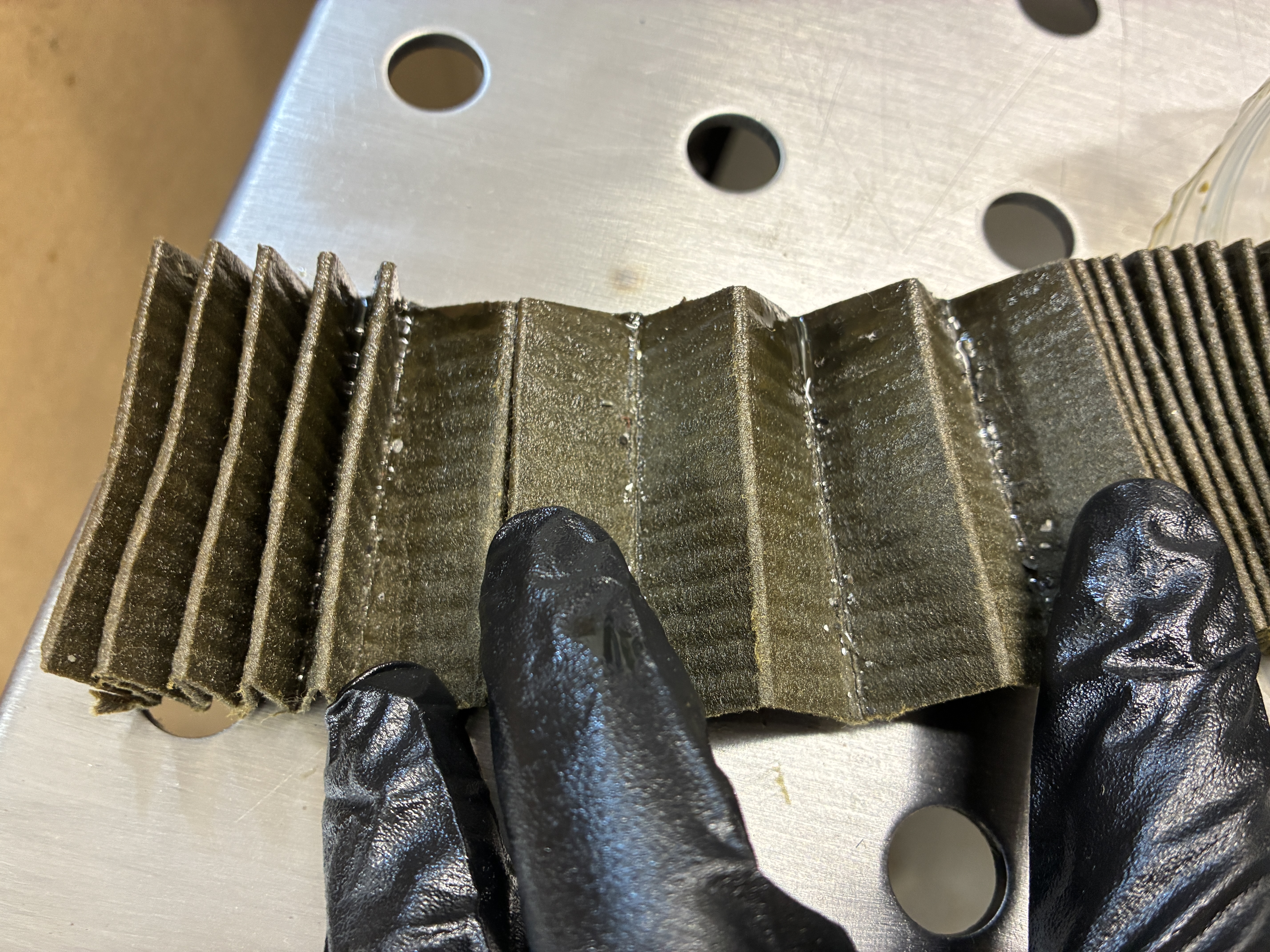

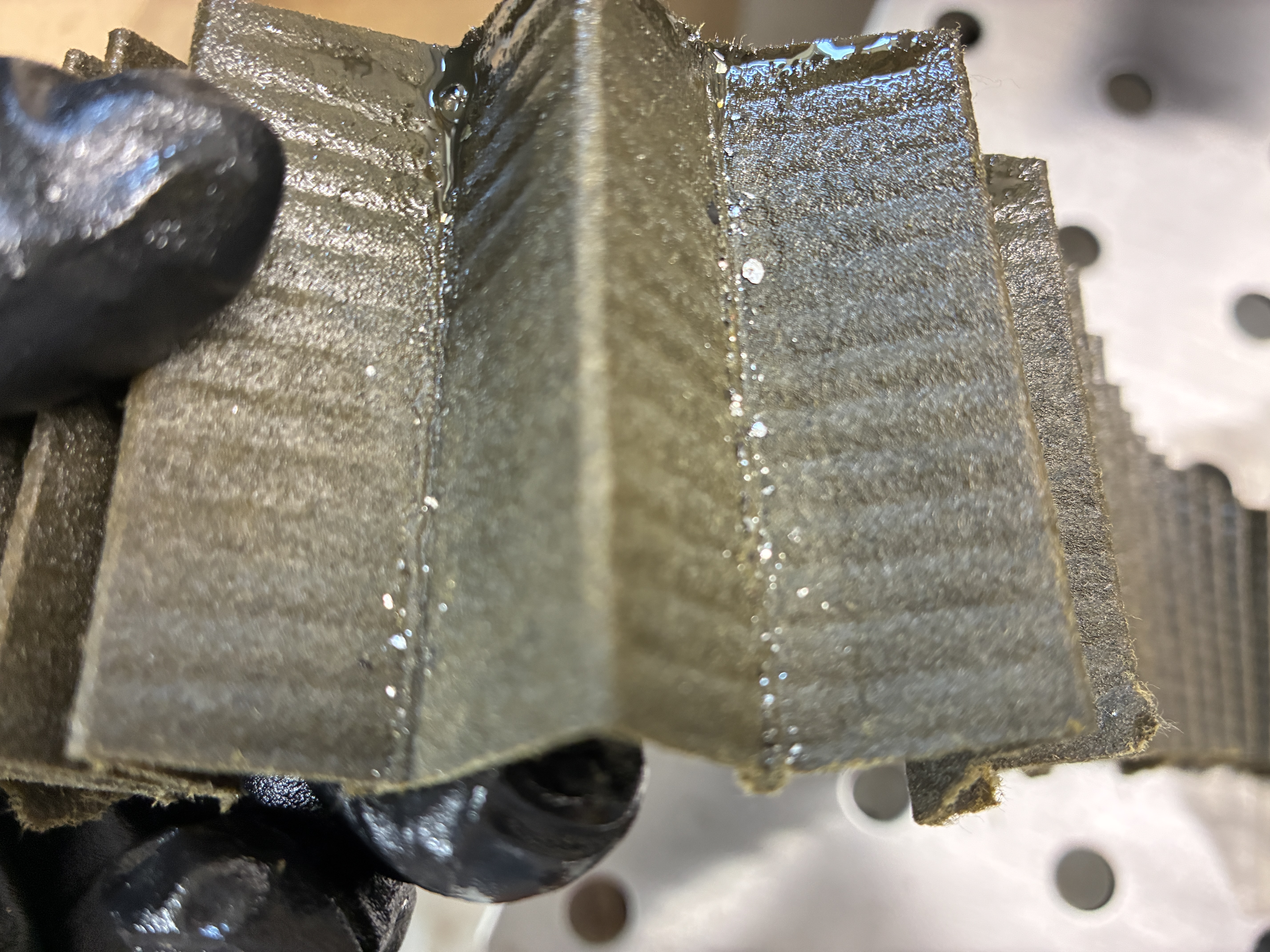

I did an oil change when I got home from Oshkosh this year and got a heck of a surprise when I cut open the oil filter. Lots of sparkly debris in the filter element as can be seen in the attached pictures. All pleats looked like these. None of the shiny metal particles are magnetic, and from their color, appear to be aluminum. The other dark debris appears to be carbon since it can be crushed with a fingernail. All of my previous oil changes have had spotless filters, so something happened in the last 25 hours. I had no operational indication of problems. Oil pressure has always been and is still right where I'd expect it to be: 50ish psi within 10-15s of cold start, 43ish psi in cruise, and 18-20psi at 800rpm when hot. The engine starts and runs great and performance has not noticeably changed. However, in this 25hr oil change interval, I noticed that oil consumption has increased. This engine used to go through a quart every 25hrs, and is now more like a quart every 10hrs. Not bad overall, but still a large percent increase and it's pretty clearly coming from the breather and not out the exhaust pipes (drips from the breather tube at the end of a flight, oil on the belly behind the breather tube but not behind the exhaust pipes).

I would be concerned too if I saw a filter like that.
Chrome cylinders by any chance? That would be my first guess.
2nd guess would be something "kinda solid" got wound through the oil pump and got deposited everywhere.
I like Blackstone, they do a good job of breaking down the individual metals.
So you've done 5 hours and found almost nothing. Try 10 hours and see what that yields. It's almost as if something Aluminum..?? rubbed on something, wore itself through and called it quits and went back to behaving. (that's really technical!!! ;) )
All of the items I can think of that cause real problems are magnetic. However a piston pin rubbing on an abrasive cylinder wall will do that. At what "O'clock" position is your odd spot in cylinder #4? A good borescope will show many things.
Also, something may have gotten in a cylinder and scored a piston, that will do that. About 10?? years ago, champion had issues with their spark plug porcelins coming apart and bouncing around inside the combustion chamber. I saw oil filters that looked like that back in "those days".

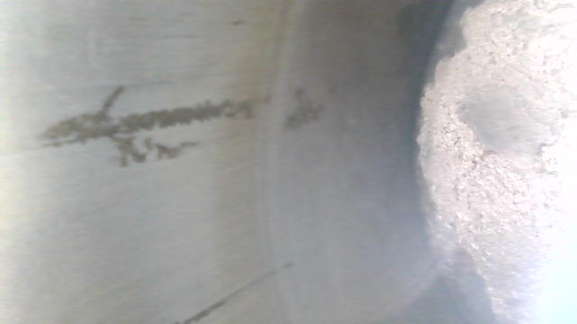

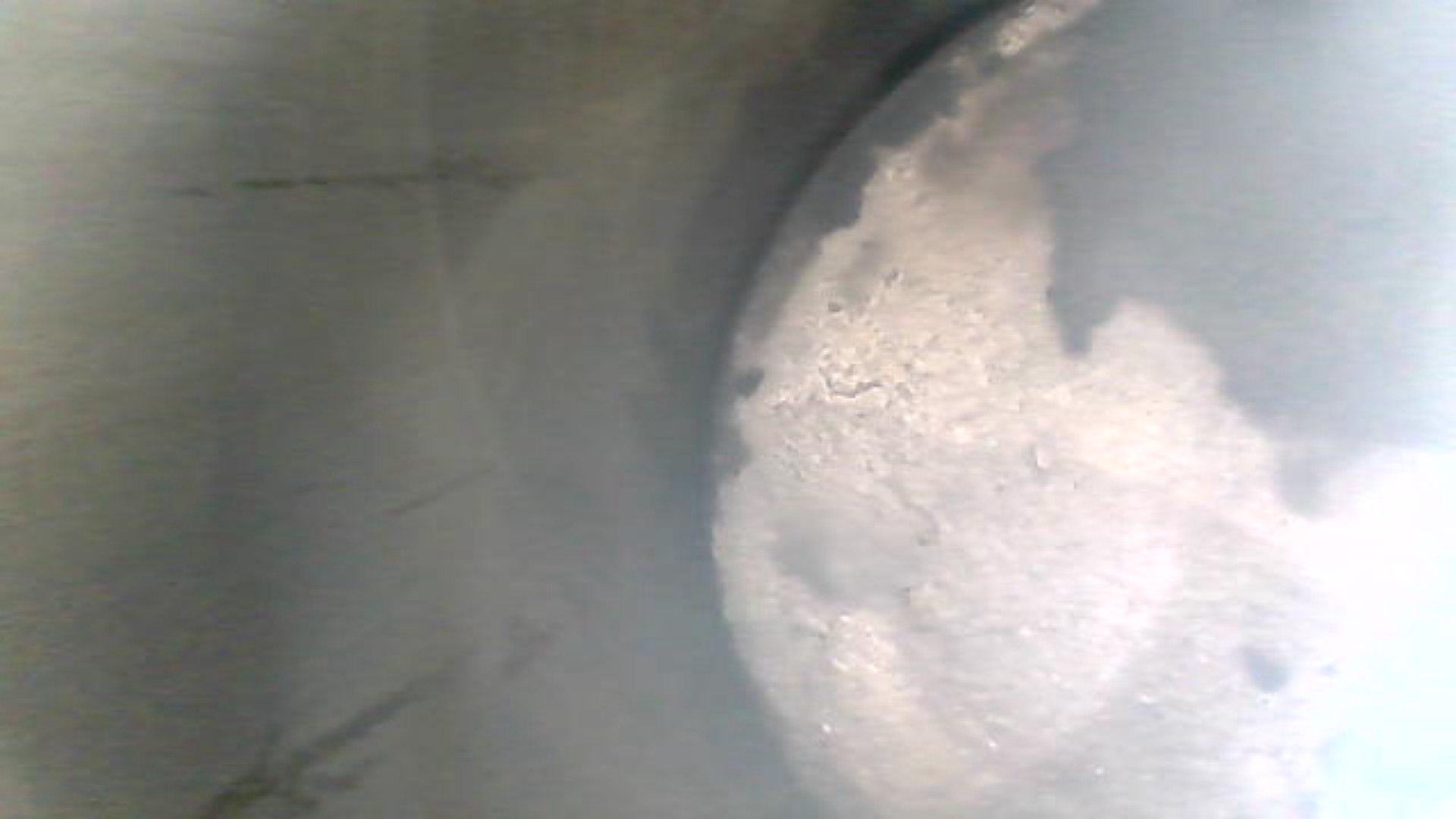

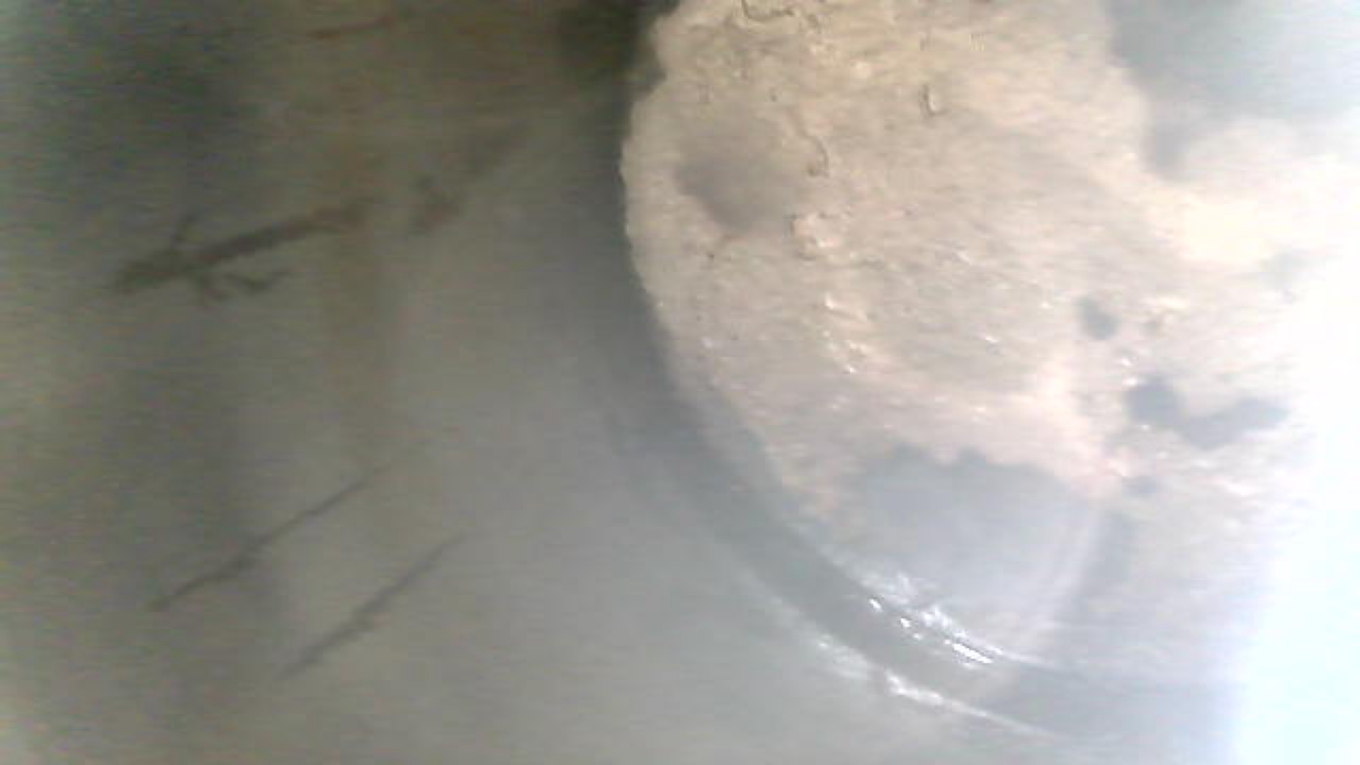

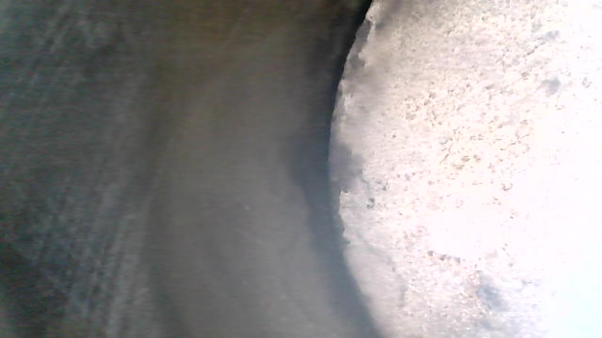

Post by bill_e »
My borescope is kind of terrible, but these are the pictures I got of cylinder #4. The borescope is coming in through the top spark plug hole and oriented approximately level with the crankshaft axis. Piston is at bottom dead center. The larger sort of arrow shaped stain in cylinder #4 is slightly above 8 o'clock position and the two smaller stains are approximately 7 o'clock as you'd stand on the left side of the airplane looking at the top of the cylinder. Wrist pin caps was the first thing my A&P thought of when I told him I had aluminum in the filter, but if these marks were caused by a dragging wrist pin, I'd expect them to be right on 9 o'clock and extend much farther down into the bore past the top of the piston. As a comparison, I included a picture of the adjacent cylinder #2 which appears flawless to me.
To the best of my knowledge they're not chrome cylinders. I only looked at the top 4 plugs since I had them out and they all appeared consistent color with no obvious missing chunks from the ceramic. Mag checks are fine too, so I would expect similar from the bottom plugs. That said, I did have the generator replaced with an alternator last annual which was within this 25hr window. While I'd hope not, I suppose it's possible for something to have been dropped into the accessory case during that work?

Bill, is the crosshatching gone in cylinder 4? I can clearly see the crosshatching in cylinder 2.

Re: Metal in the Oil Filter
A chrome cylinder should have a painted band around the base of the cylinder, orange, IIRC.
That cylinder does look like it's worn through the cross hatching. I'd be thinking about pulling it for inspection unless I found some other smoking gun.

The suggestion to pull the starter is a great one, also pulling a magneto is easy and painless to look around the back of the accessory case.
I've borescoped countless cylinders and never seen a mark like that! John's suggestion to pull the cylinder is spot on.

John, while the bases of the cylinders aren't painted, I checked the cylinder serviceable tags in the logs and all of them had the CermiNil process applied when the engine was overhauled in '97. Cylinder #2 was pulled in '01 with just a note that the bore was honed (along with a bunch of valve guide and seat work). Probably why the crosshatching is more visible on that one than the others. I agree that the cross hatching appears worn through on #4 and I wonder if the stains are maybe spots where the CermiNil coating has flaked off or worn through? For what it's worth, compression on #4 last annual was 76/80.

Cermi-nil is a completely different process from Chrome plating. It is plausible that the bits in the filter are from the markings on the cylinder wall.
