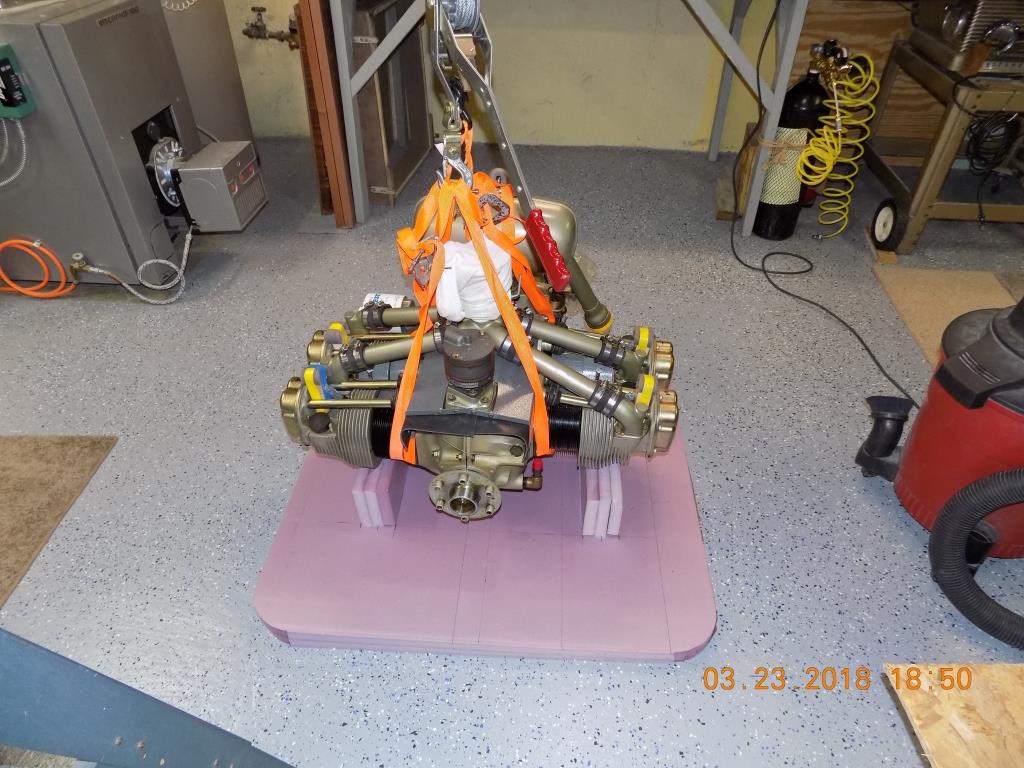

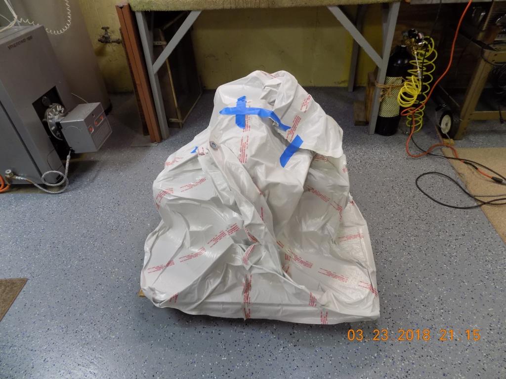

I tried four methods to preserve my engine long term. The dessicant dryer method by Ron Barker, storing the engine in a plastic bag that was evacuated with a vacuum pump, putting a nitrogen blanket over the engine, and buying the Protective Packaging solution. Protective Packaging worked the best with no maintenance, and it keeps humidity levels less than 40%. See attached photos. Details at protectivepackaging.net

More Photos. The key is to keep the RH < 40%. I learned of this solution by viewing the video at https://www.youtube.com/watch?v=ecCAklmipcU on how to preserve a 731 Honeywell jet engine. Although my engine is off aircraft, Protective Packaging offers many solutions for sealing odd shaped parts. I can imagine a barrier bag around the entire column of a Cessna 140. The barrier bag lets in air, but it prohibits water vapor. Key to preventing corrosion is eliminating water vapor, eliminating oxygen, or both. The barrier bag eliminates water vapor. The bag kit cost me $335, and the tech rep told me it is good for 5 years indoor storage--2 years outdoor storage. The MIL-PRF-131 bag is the key to the solution. My humidity plug has stayed at 30% or less for 6 months now.
