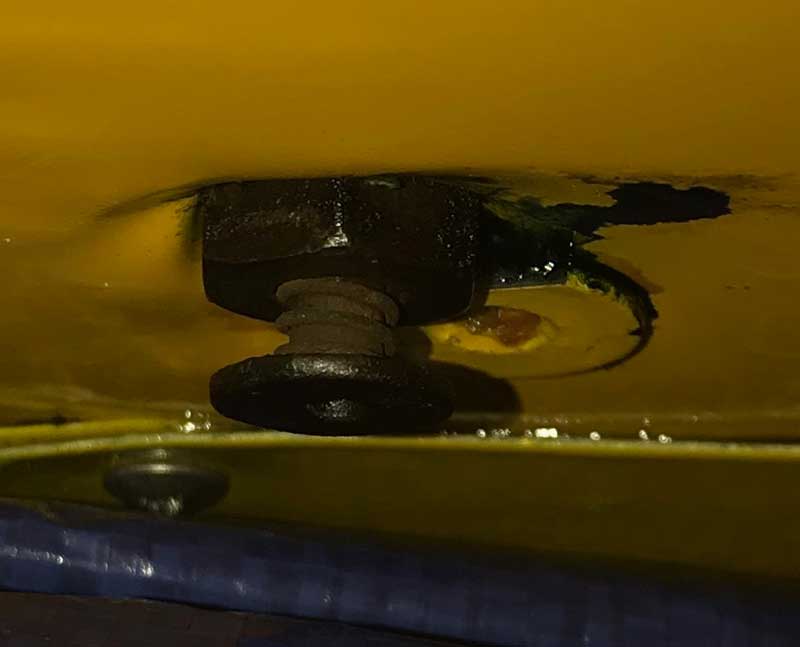

Yeah, I think that's right. Look closely at the one that's in there now. If it's drilled for safety wire it is probably straight thread, even if it doesn't have the safety wire installed.

by 8359
Here's a photo of mine. It does appear to match the one in the link I sent.
