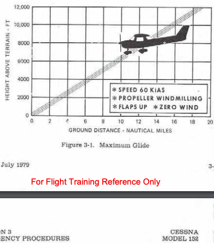

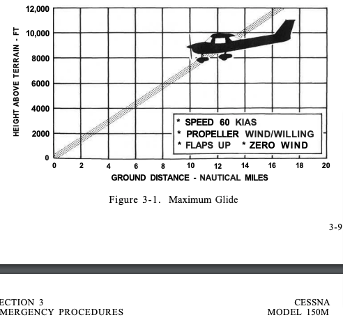

I apologize for my ignorance... how did you came up with that conclusion. I got this approx. glide ratio from the POH
C150 = 8.5 (14NM / 10k')
C172 = 9.1 (15NM / 10k')
C152 = 9.7 (16NM / 10k')

Take a look at the POH
