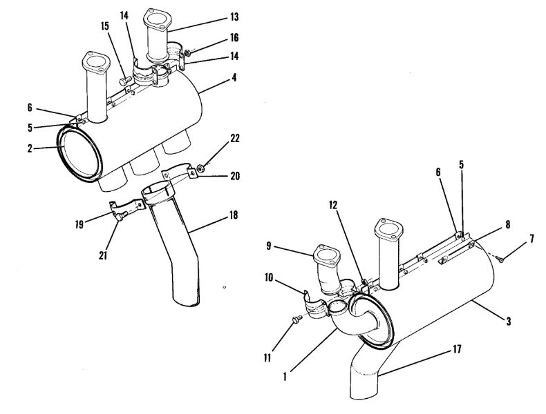

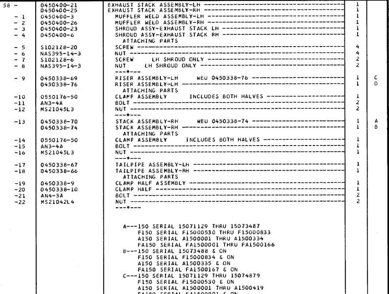

You will need to find either the parts book for the later C-150's. (mid 1970's, before they started making the C-152) to get the exhaust shroud p/n.
1976 parts book dated
