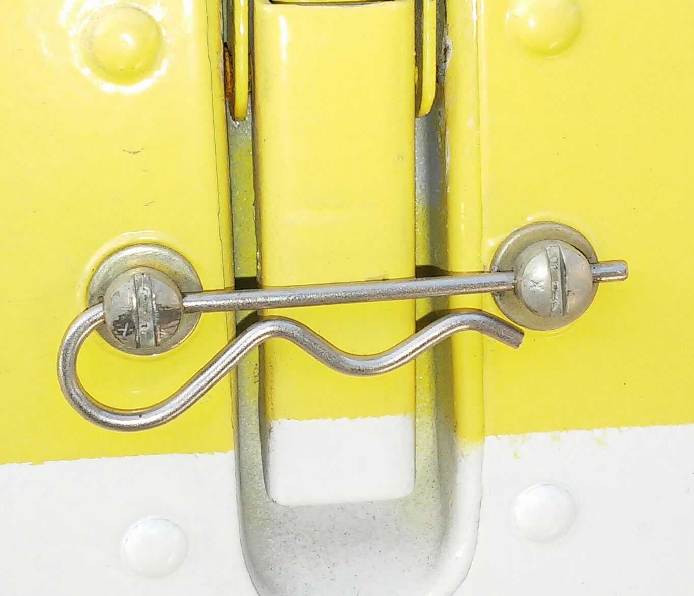

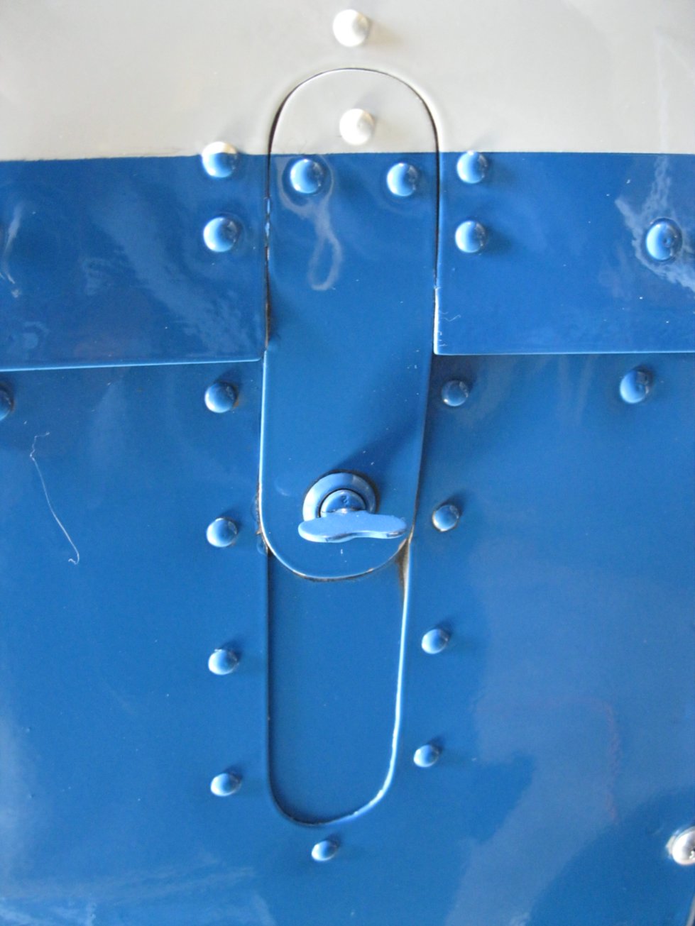

When the old latches start to fail some folks do something like this....
But I went with the Davis option when my old latches failed....

7313 wrote: Sat Mar 30, 2019 12:03 pm How are the safety pins used? Wheredo they attach?
There is a "U" shaped bracket attached behind the lower part of the latch, near where the pin is in the photo above. The ends of the "U" are drilled and the pin goes through the holes and across the latch handle.

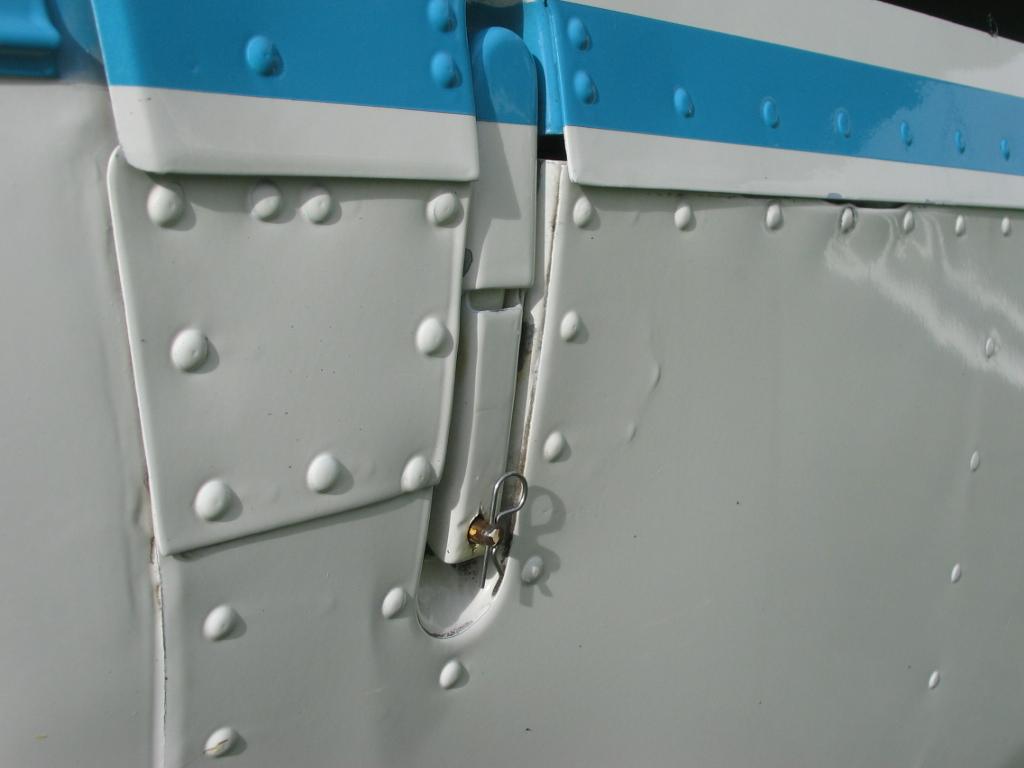

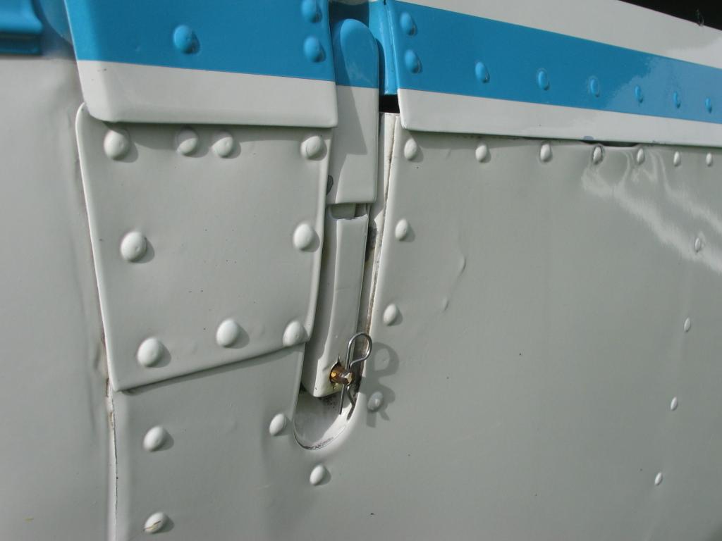

Posted: Wed Apr 03, 2019 12:37 am
by 5422
I copied this from another member can’t remember who. Anyway it will keep the latch from fully opening. Easy to make and I think they look good and I’ve never had the pins come out.
