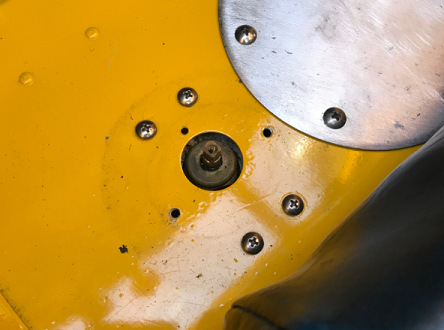

Thanks for the help guys. Finally got around to this today, unfortunately I couldn't get the bonnet off. The wrench doesn't fit in through the side and have enough clearance to wrap around it and turn and the socket diameter is too large where it won't fit through the clearance hole. I'm tempted to widen the clearance hole around it. Is there a better way? The Winter 2016 article mentioned it's serviceable without removing the entire valve, but I'm not sure if there's a trick to it.
Thanks all for the help.

Posted: Mon Jan 28, 2019 5:34 am
by 6277
It's easier to take the selector valve out and repair it on a work bench. Be careful when draining the tanks...if you're in cold country static electricity can build up easily. Read Neal Wright's article on Fuel Selector Valves for more information.
